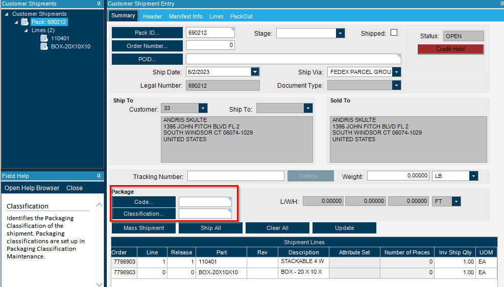

Right now we’re thinking of having laminated sheets, where the packers can scan a bar code in Customer Shipment Entry. Unfortunately, I can’t figure out an easy way to issue the right box as they’re packaging the order.
I thought maybe I could add a line to the pack for the box, but Epicor wants to associate it with a sales order line and release. The salespeople wouldn’t know, and the shippers decide on box sizes based on what’s in the tote as it makes it to the shipping station.
What have you all done?
On the header there is a box for Package. We use that and added a UD field to record the count. The drawback with this is if you use more than one type of box for one order.

There are two ways to handle that. We have added a UD field on the header to record the number used. With this field we have created a report that is used to issue the packages used at the end of the day to record consumption.
You can also automate the consumption by creating a method directive on the pack being marked shipped.
Have you looked at the PCID functionality as i believe this will do what you need - you need to have the AMM licence from what i recall
@Vinaykamboj - Thanks. How does the method directive consume the packaging materials? Does it do a Qty Adjustment with minus the # of boxes used, cross linking a box partnum to the package code?
@SueLowden - Thanks for the idea! We do have AMM, and have looked into PCID, but I didn’t see how that would account for packaging material inventory. How would that work?
As part of the configuration you define the inventory item that is to be consumed on shipment of a type of PCID (i.e. the shipping box) then you “pick the stock” into a PCID that is then shipped - this automatically depletes the stock of the shipping box and the contents as an ADJ-QTY with a specific reason code automatically assigned (again setup as part of the configuration)
