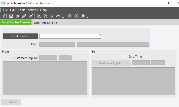

It sounds like you could alternatively use the “serial number customer transfer” form to create a CUS-TRF SNTran record that shows the transfer between the distributor that you sold it to and the actual customer. This is pretty lightweight and would give you the final location of the serial number.

Looks like this is a fairly recent feature. Talked to our consultant about it - he hadn’t played with it, and it didn’t seem to work in his version. He did mention it doesn’t seem to write to the part transaction record, so we may need to play with it further - looks promising, though!
FWIW we also use Serial Number Customer Transfer to input where our pumps sold by distributors ended up.

We use this in 10.1.600.27 and it works perfectly. It does however remove the pack slip number intentionally as the customer is changed.

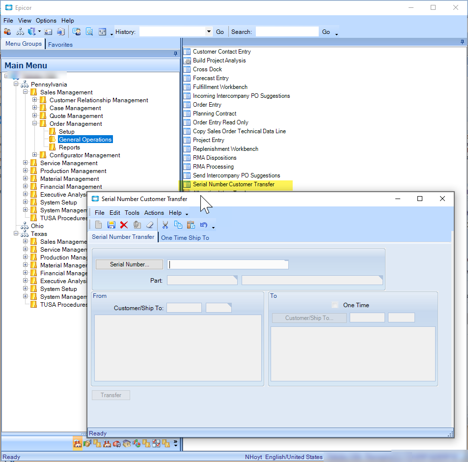

Yep. It’s quite a simple program… I’m surprised if someone found it buggy. Is there any chance one needs CRM for it or something? Here’s where I find the program:
We have played with it, and it seems to work fine - very simple, as Nancy mentioned. Our consultant mentioned that it doesn’t show up in part transaction history, but I don’t see that as a problem, as it is not a transaction that impacts inventory.
You will see the transfer in the sntran table.
