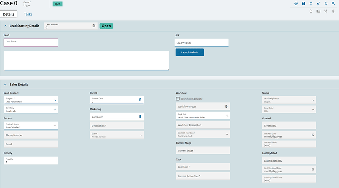

Here is what I did and none of it is fun.
  • Create a spin off page of the HDCase/helpdesk menu. (it helps so you can filter these separately and remove 90% of the stock case fields)
  • Define a task set for leads (something like contact lead, follow up, etc)
  • Create marketing campaign (Something like Tradeshows 2024), then an event for each show
  • create a customer record for the lead ( we batch them in using dmt. We also add contacts)
  • Then we DMT the lead as a case referencing that customer, contact and any other relevant info. If your territories and task sets are setup, then the task will be kicked off the the salesperson listed in that role code/territory.
