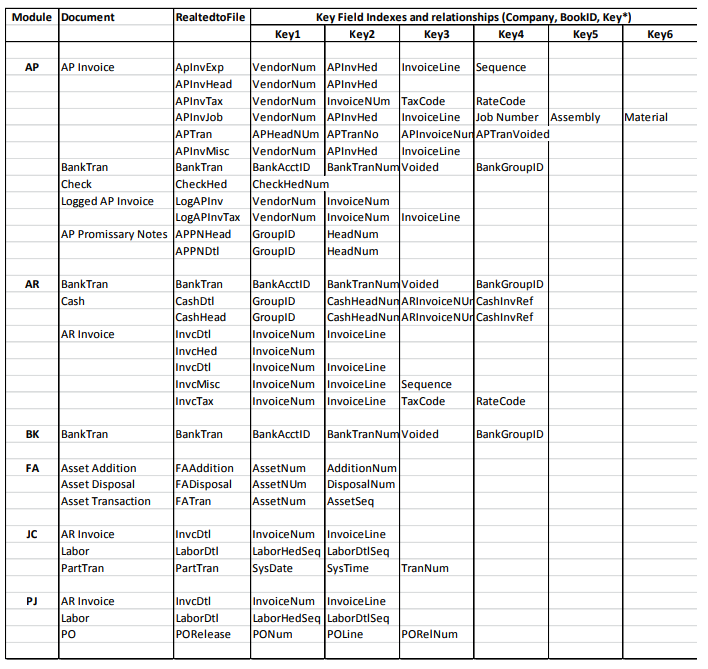

TranGLC Key Map
Does anyone have an updated map (excel or sumthin) for the TranGLC Keys 1-5 by transaction type?
TIA!
Was looking for the same thing and found in a knowledge base article on EpicCare (go figure):
https://epicorcs.service-now.com/epiccare/knowledge.do?sysparm_document_key=kb_knowledge,daa096a84f0a62803558ab99f110c7fb
Made an excel file of the info (attached)
Good luck!
TranGLC Key Map to Related Tables.xlsx (15.0 KB)
For the record, here is also the E9 Version from DotNetIT. Still some relevance. Thanks for Excel Molly! ^
I wanted to point out that the most recent revisions can be received on the EpicCare site, these two KB articles: KB0037268, and KB0028094. I’m using it for Kinetic 2021.1.11.
–J
Thanks John!
