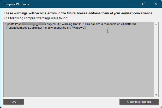

Transaction Scope Compiler Warning

Update: I uninstalled every version of .NET runtime and SDK, then I installed the version our cloud server has installed the 8.0.11 runtime and the 8.0.404 SDK. Now in addition to the warning I was getting I am getting the following message as a syntax error.
Code: CS0012
Message: The type ‘TransactionScope’ is defined in an assembly that is not referenced. You must add a reference to assembly ‘System.Transactions.Local, Version=8.0.0.0, Culture=neutral, PublicKeyToken=cc7b13ffcd2ddd51’.
It doesn’t prevent me from saving the BPM and enabling it, it’s just very annoying. Has anyone got this warning to go away?
Just for context, if I use the following code I get the syntax error:
using (var txScope = IceDataContext.CreateDefaultTransactionScope()) {
        //Any Business Object Update Code Here
        txScope.Complete();
If I use the following code (for the sake of testing) I don’t get the syntax error:
using (TransactionScope txScope = new TransactionScope()) {
        txScope.Complete();
But either way I still get the compiler warning message.
I’m seeing this too we’re SaaS so have no control of the server.
Only supported on Windows… That’s really funny
I’m surprised no one else has the answer on this yet… This is due to the move of SaaS servers to Linux. Instead, use (when it becomes an error):
using (var trx = TransactionScopeFactory.CreateDefault())
@Epic_Santiago
Hi everyone,
We have introduced some new warnings to verify that code is cross-platform. This is in preparation to moving to Linux for 2025.1. The warning was backported to 2024.2 to help identify such code prior to the upgrade. You can find examples of code that is not cross-platform (like the Windows registry) here:
TransactionScope.Close() however is a false positive as this method is indeed portable. This has already been fixed and the warning should go away in the next build.

Thank you @Epic_Santiago I’ll keep my eyes out for any warning not referencing TransactionScope.
@Epic_Santiago I got one for you warning CA1416: This call site is reachable on all platforms. 'MailPriority.High' is only supported on: 'Windows'.
I just checked and with the fix, MailPriority.High doesn’t give a warning. Add this one to the list of ones to ignore. Sorry for the hassle.
What about the use of System.Xml namespace? I use it to extract information from BpDirective table, Body field which is stored in XML.
warning CA1416: This call site is reachable on all platforms. 'XmlDocument.LoadXml(string)' is only supported on: 'Windows'
