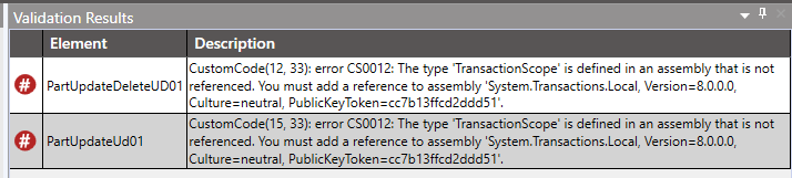

we are getting Transaction Scope errors as well. Was happening in production prior to update this weekend and is still happening this morning. It’s a BPM that fires when adding parts to a custom forecast program. The BPM is working but i’m curious about the validation error and if i should be concerned?
the program was developed by Epicor’s Custom solutions group and they couldn’t figure it out last week either.
Your error is not the same type. That is a local machine error. If you save, it will be fine.
There is likely a folder you will have to delete to correct it. Let me see if I can find the thread.
Unless @olga remembers first…
I also just discovered if I remove the custom code from my BPM, I continue to get these errors. That’s a new one for me.
I cannot find anythig similar, probably because people just show screenshots instead of writing the error itself. :woman_shrugging:
But the error you mentioned was because of SDK not correctly installed locally and I don;t think this is the same. In that case it was erroring everything starting with String

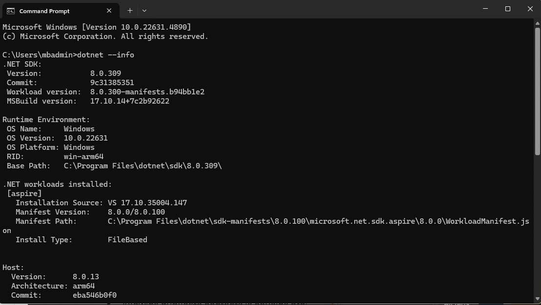

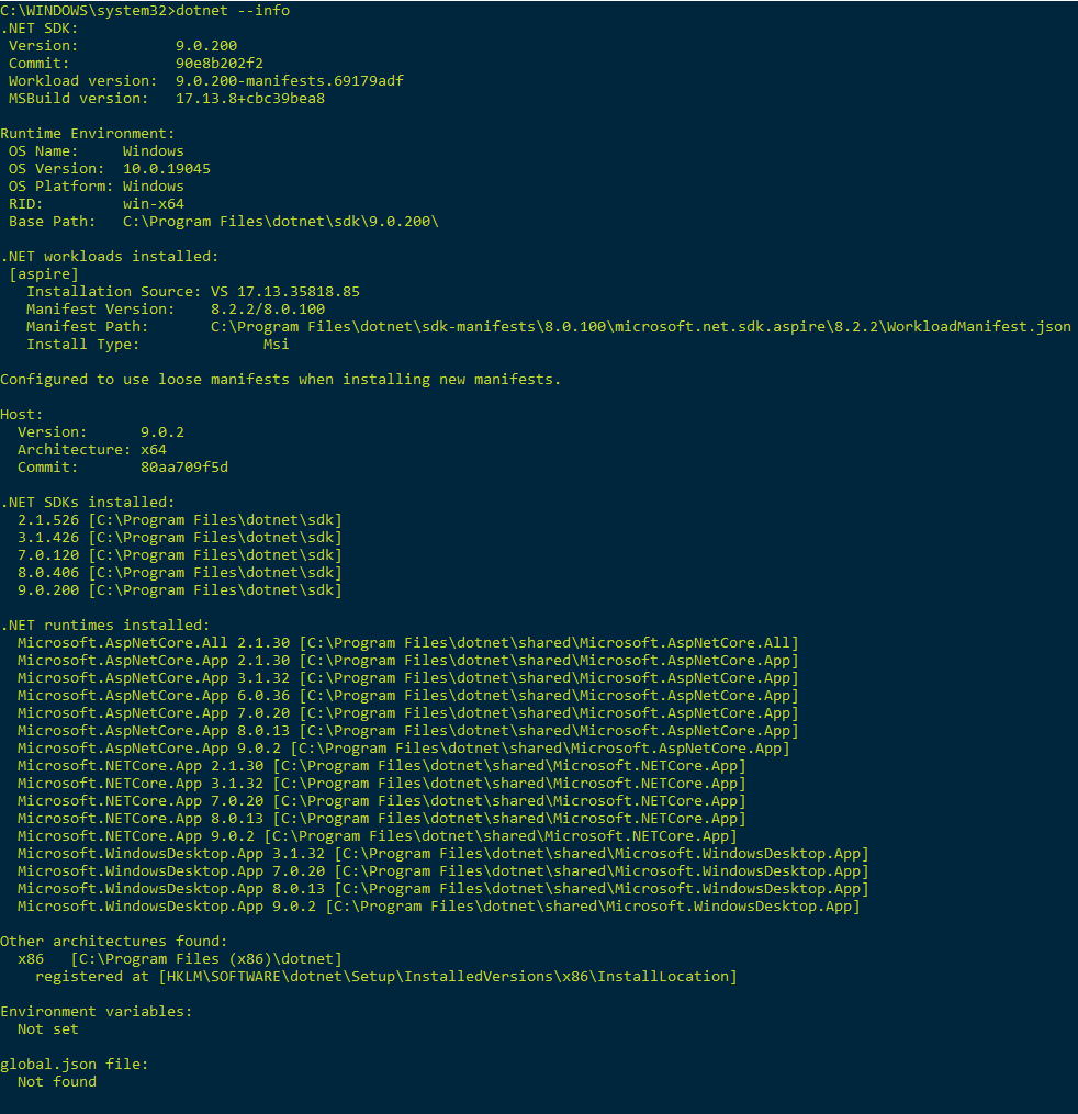

do you have .NET Sdk 8x installed locally? show us:
dotnet --info
Didn’t work for me. I removed 6.0x of the SDK and already had 8 installed. Still seeing the errors. Maybe an issue with ARM in my case?
