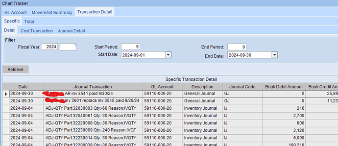

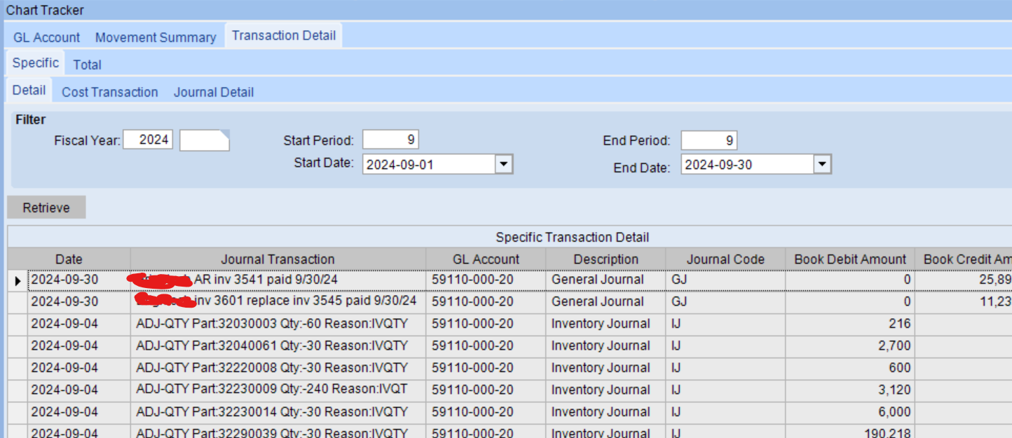

In fact, the reason this question arose was because the Inventory adjustment account contained an unexpected transaction. I previously thought that Inventory adjustment accounts would only have ADJ-QTY and similar types. However, the accounting team said that the data from the inventory management department did not match the ledger, so we looked into it and found that transactions related to AR Invoice were also included in this account, as shown below.
So what I wanted to know was what transactions each GL account was bringing in.
looking at your screen - the Journal Code of GJ could be your smoking gun.
Search for the journal number on that transaction and you could ask the user that performed a journal entry against a controlled account why they did the entry.

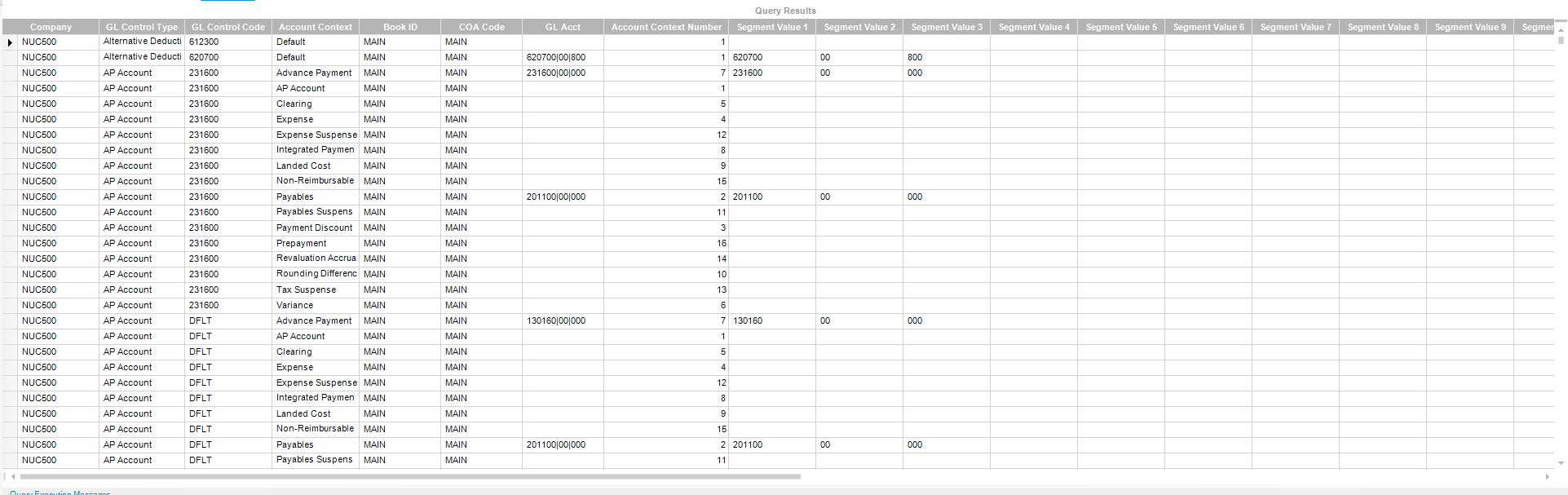

You can create a BAQ to the table GLCntrlAcct and youll see on which gl acct type and context the accounts are set
