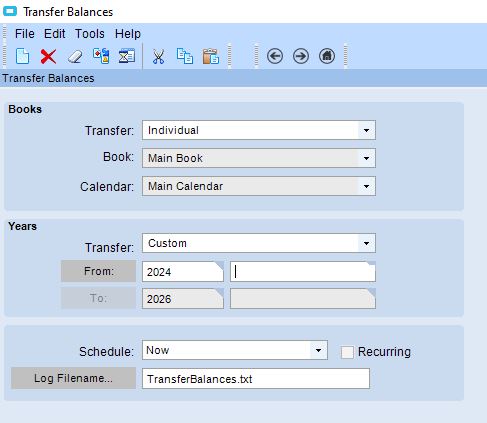

Transfer of opening balance
We are currently in fiscal year 2026 (April to March). We have to do transfer of opening balance from 2024 to 2025.
In custom option, I could give From : 2024 but by default it came To: 2026
I cannot edit To: 2025
please advise what to do
I think you’d have to make 2025 your active FY but I’m not sure you can even do that now.
You need to change your Book’s “Future Opening Balances” option (in Book Maintenance) to Manually update future balances:
If it is set to Auto Update, then the Transfer Balances process will default to the most recent/active fiscal year.
Ah, nice. I was going to say I could change the dates but I did not remember that was why. I assumed it was the last apply date or something.
Give this man the solution!
Thank you.
Thank you. it worked!
