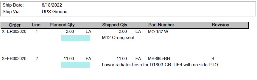

I tried to add the field where the label for part description was so that there wouldn’t be any visibility issues with the field or the row…the blue section is where I’m trying to add the Pick List Comment…
But when I add the field in the report, it comes through blank. No errors, just blank…not sure what I am doing wrong?

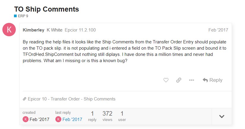

Yes, we chose examples with content in both the PickListComment field as well as the ShipComment field…I wonder if it could be a bug…I ran across this in the history of the forum?

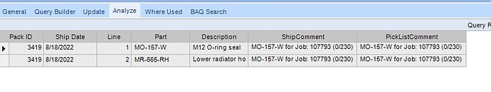

I do get it to come through on a baq with the following query (the person who entered the comments duplicated in both fields so I could test them both but they are correct)… (thank you so much for your time, btw!!)
select
[TFShipHead].[PackNum] as [TFShipHead_PackNum],
[TFShipHead].[ShipDate] as [TFShipHead_ShipDate],
[TFShipDtl].[PackLine] as [TFShipDtl_PackLine],
[TFShipDtl].[PartNum] as [TFShipDtl_PartNum],
[TFShipDtl].[LineDesc] as [TFShipDtl_LineDesc],
[TFOrdHed].[ShipComment] as [TFOrdHed_ShipComment],
[TFOrdHed].[PickListComment] as [TFOrdHed_PickListComment]
from Erp.TFShipHead as TFShipHead
inner join Erp.TFShipDtl as TFShipDtl on
TFShipHead.Company = TFShipDtl.Company
and TFShipHead.PackNum = TFShipDtl.PackNum
and ( TFShipDtl.TFOrdNum = ‘XFER002020’ )
inner join Erp.TFOrdHed as TFOrdHed on
TFShipDtl.Company = TFOrdHed.Company
and TFShipDtl.TFOrdNum = TFOrdHed.TFOrdNum

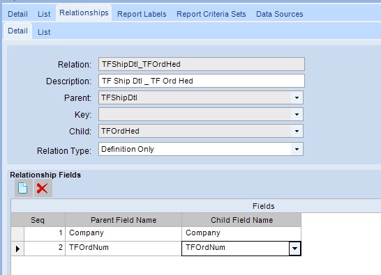

Try changing the relation type in your RDD from “Definition only” to “Output”. This is the only way I’ve consistently been able to get results when adding tables to RDDs.

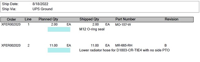

OMG, that worked!!! You are my hero!
Thank you so so much!!
