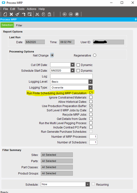

Is it scheduling over capacity within the finite horizon? Just to confirm, are you checking “Finite Load” / “Run Finite Scheduling” before you run Global Scheduling or Process MRP?

They’re parameters/check boxes on some modules that you can schedule with. (Global Scheduling, Process MRP, Job Entry Scheduling) How do you currently schedule jobs?

Gotcha, I would check the MRP parameters then.
Well it looks like the job entry parameter is “Finite Capacity” and the global scheduling is “Finite Load”. Have you tried checking the finite capacity box on the job entry?

In a sense. The finite scheduling will only apply to job operations where the resource is marked as finite. So a job could be both finitely/infinitely scheduled depending on how its operations resources are set up.
