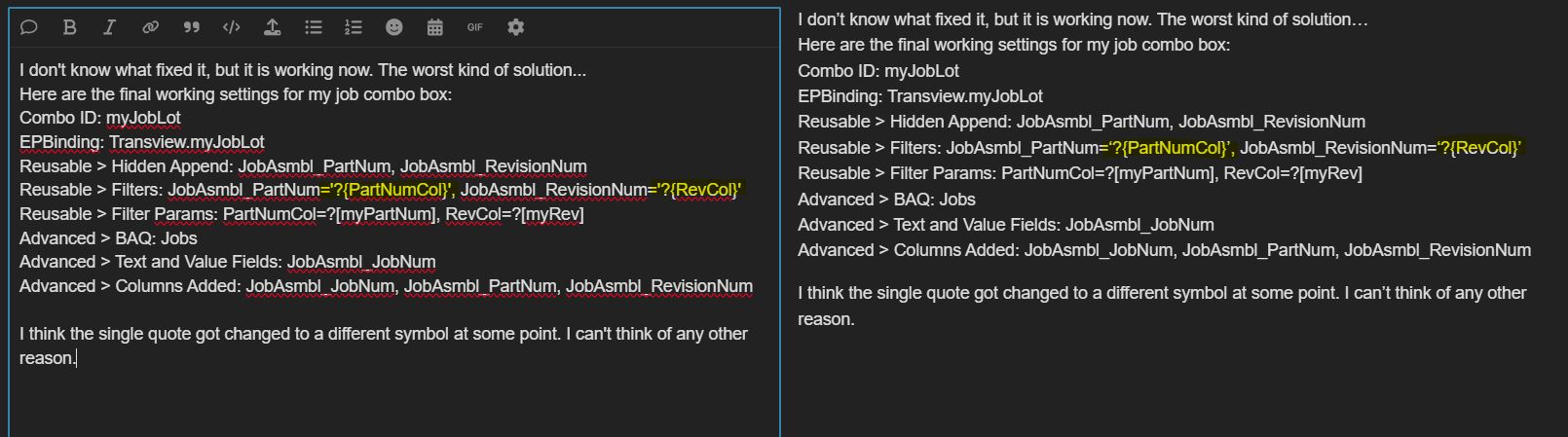

I think the single quote got changed to a different symbol at some point. I can’t think of any other reason.
Confirmed it was Epiusers copy/pasting that messed up the single quotes. Look here you can see the text that I posted, and the text as epiuseres formatted it. I should have used a code block!:

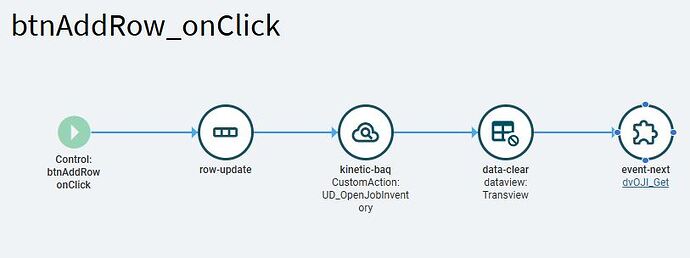

That was great! Here is my AddRow Button event for my records:
row-update > Parameters > Columns > Ep Binding: CallContextBpmData.Character01
row-update > Parameters > Columns > Value :“{Transview.myPartNum}” (straight quotes not curly)
Kinetic-baq > BAQ ID: UD_OpenJobInventory
Kinetic-baq > View Name: myDV (What do I use this for?)
Kinetic-baq > Mode : Update
Kinetic-baq > BAQ Update Options > Operation: CustomAction
Kinetic-baq > BAQ Update Options > Action ID: AddRow (I named this inside my UBAQ, and reference it in the BPM)
data-clear > Param > Type: Dataview
data-clear > Param > Value Transview
event-next > Event Id: dvOJI_Get
