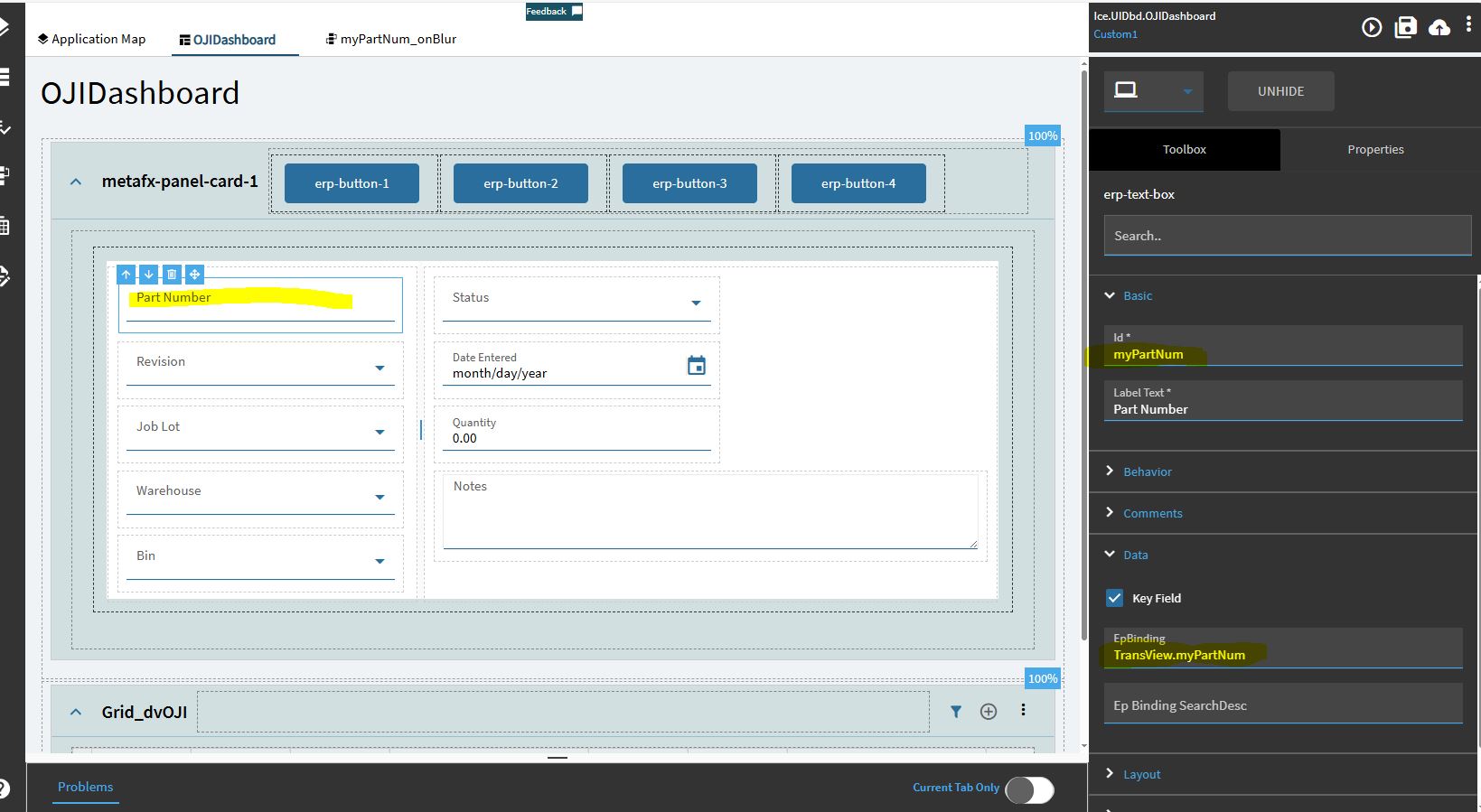

Here I setup my text field and epbinding.

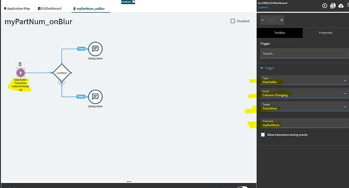

And here is one way I have tried the event. I also tried using the stock onBlur. The condition is:
‘{TransView.myPartNum}’ !== ‘undefined’ && ‘{TransView.myPartNum}’ !==‘’

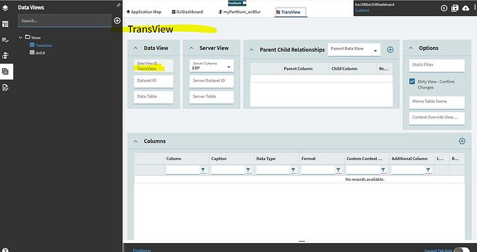

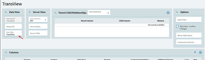

Here is the TransView dv:

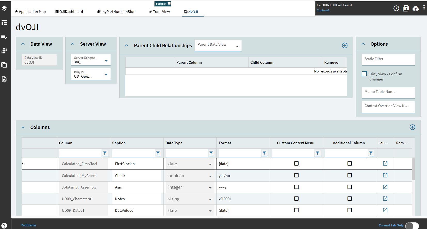

And here is the dv generated by the wizard for the grid. This part works fine, just for reference:

Both had same result, nothing. I suspect my event isn’t firing at all since i have dialogs on true and false, something should pop a dialog.
Edit: Confirmed! Even a stock onblur event does not trigger when leaving the text box. I put just a dialog after the onblur event and couldn’t get it to trigger. I tried to convert the event trigger to Datatable and dataview, but nether of those worked either.

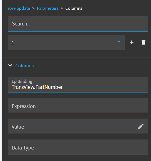

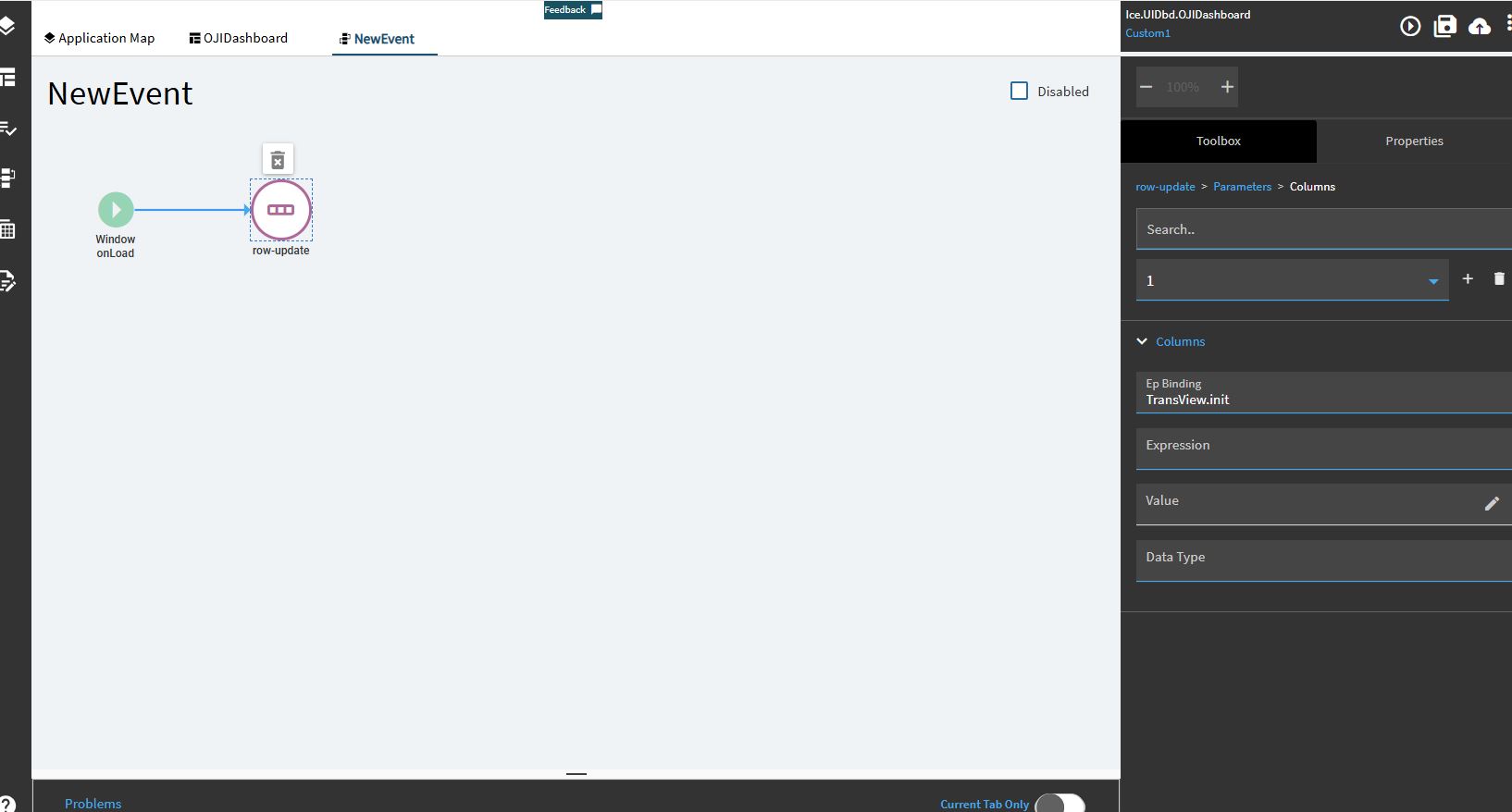

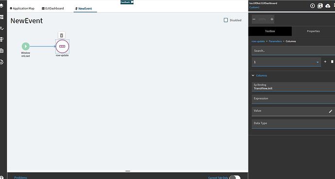

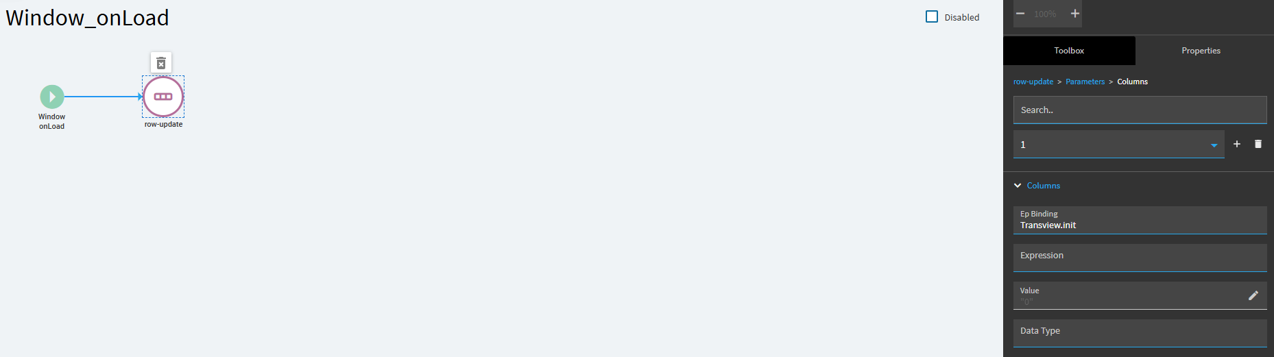

When you’re making your own dashboard and using Transview, you have to initialize it before the dataview will do anything. Make an event like this:
Doesn’t really matter what field you use in the Transview dataview or what you set it to.
I added this event as instructed. No change.
I don’t see a value in your screenshot, did you set it to anything? I have “0” in my value field for the row-update, though it is really hard to see it in the screen shot.
I did miss that, but even after I added the “0” in, the TransView doesn’t seem to get values when i type them into the bound textboxes. Also the onblur event on my part number text box still wont fire. :thinking:

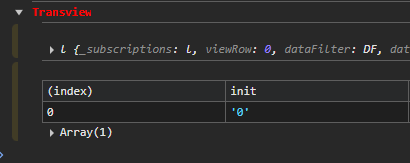

What does the dataview in debugger show? Is the dataview there and has changed?

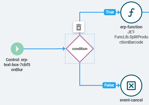

I have a custom text field with an onblur event fed into a condition that appears to be at least part of what you’re trying to do.
My condition is:
“{TransView.BarcodeScan}” !== “undefined” && “{TransView.BarcodeScan}” !== “”
Maybe its your single quotes vs double quotes? But this was also in a modification to start production activity, so I didn’t have to create a TransView.

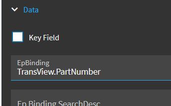

I noticed mine had this field filled in, but your screenshot did not. Not sure what it does or if its required.
For my field I did not have to check Key Field

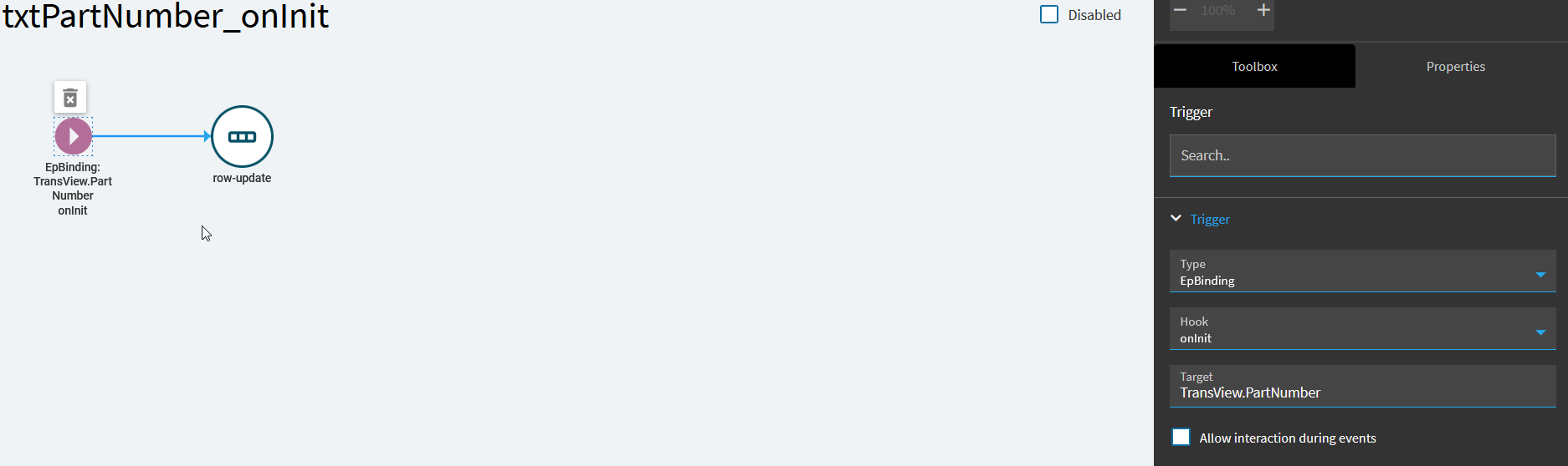

Under On Create I initialized it.

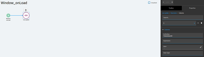

Throw in the row update. Don’t do anything really to it, except create the column.
After that my dashboard departs. I start filtering the grid using the BAQ Options Where List.

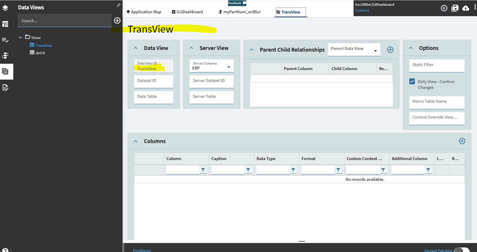

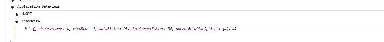

The TransView dv shows nothing, nothing before and nothing after.
It looks just like this before and after i type a value into the textbox.
If that windowOnLoad event were firing, then the TransView should be red when you open the dev tools and have that init field listed. Like this

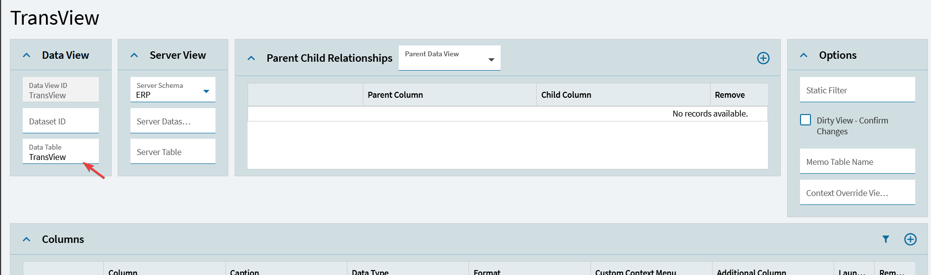

  2. Create Transview dataview (I don’t know if it really matters and it 100% shouldn’t, but I noticed you capitalized the V in Transview and it’s not normally like that. Again shouldn’t matter but superstition and whatnot)
