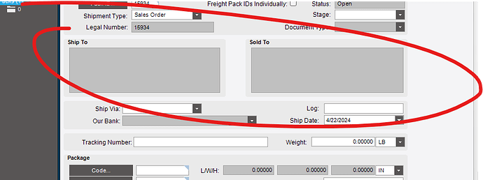

I am using some code on a form customization to add packs to a masterpack and when it finishes all the packs are added as expected, but none of the address fields are displaying the address or the ship to…
If I close the master pack and re-open it… the address loads into the appropriate textboxes.
Getting flustered at this point and don’t want to do something hacky, like close the form and re-open to see the changes.
I’ve tried this.oTrans.Refresh(), Update(), NotifyAll(), validatekeyfield(mytextbox), etc.
If anyone has any last tips they would be much appreciated.

I started doing some more debugging cause I wasn’t getting what I wanted trying to do everything the server trace was giving me so I did an after adapter method and popped up the adapter methods that were being called… That brought me to search ResetList() on here which got me to a post by none other than @Chris_ConnOrder Release Method - #2 by Chris_Conn
I added that before my oTrans.Update() call like this and it worked! My form now displays the changes.
Maybe @Chris_Conn can explain what it is that ResetList is doing and what the reset list mode is for, or anyone else on here other than me… cause I have no clue… but it works… and I hate saying that and not knowing.
