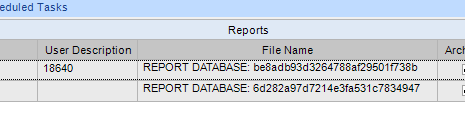

If the report style is set to output to database rather than XML, running the report should result in a GUID being generated and a set of tables with that GUID in their names being created in the EpicorEnvironmentName.Reports database (e.g., Live.Reports). But I’m not sure how you’d obtain that GUID to pass it to SSRS.
The System Monitor should be able to get the GUID but not the Document number since you can be printing more than one document per print session.
One might be able to put the document ID in the User Description and then you would know both.
But once you’ve done that work, you have what you need to get the byte stream from the Monitor…

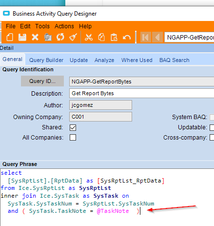

I sound like a broken record but I use a UBAQ. UBAQ UBAQ UBAQ UBAQ why fiddle with all this stuff when you don’t have to. In 10.2.500 change UBAQ to Func but same concept
Simply write a BAQ which takes in a Parameter (Invoice Number?)
Then in the UBAQ Post Processing on GetList() you can do this
foreach(var x in ttResults)
using (var ar = Ice.Assemblies.ServiceRenderer.GetService<Erp.Contracts.ARInvFormSvcContract>(Db))
    ARInvFormTableset ARts = null;
    ARts =ar.GetNewParameters();
    ar.PackNumDefaults(ref ARts);
    ARts.ARInvFormParam[0].AgentID = "SystemTaskAgent";
    ARts.ARInvFormParam[0].AutoAction = "SSRSGenerate";
    ARts.ARInvFormParam[0].CalledFrom = "Erp.UI.ARInvoiceTracker";
    ARts.ARInvFormParam[0].DateFormat = "m/d/yyyy";
    ARts.ARInvFormParam[0].InvoiceNum = x.InvcHead_InvoiceNum;
    ARts.ARInvFormParam[0].NumericFormat = ",.";
    ARts.ARInvFormParam[0].ReportCultureCode = "en-US";
    ARts.ARInvFormParam[0].ReportCurrencyCode = "USD";
    ARts.ARInvFormParam[0].SSRSRenderFormat = "PDF";
    ARts.ARInvFormParam[0].TaskNote = taskNote.ToString();
    x.Calculated_ReportGUID = taskNote.ToString();
    ar.RunDirect(ARts); //This runs the report right away but it hangs until it finishes...
    //ar.SubmitToAgent( ARts, "SystemTaskAgent",0,0,"Erp.UIRpt.ARInvForm"); this uses the system agent and returns right away but you'll have to POLL until your Report is Ready
Note that I put a GUID (my own GUID) in TaskNotes and return that back with my UBAQ Response Data in Calculated_ReportGUID Field
Now the BAQ will return back (VIA REST) the GUID of the Report that I just ran.
Then Simply you can use another UBAQ to get the Report Data out of the table once the Task is Finished.
The ReportBytes (after it has run) are stored in SysRptList (SSRS Only)
So your other BAQ should be pretty simple (see below) is just a query to SysRptList where the Data is Filtered by the TaskNote of my generated GUID (as a Parameter)
So in other words,
You make a simple
GET Request to your first UBAQ with InvoiceNum as a Paramter
It returns a GUID in Calculated_ReportGuid field
Which you then use to make another
GET Request to BAQ #2 which will return the Report Bytes

Here’s a quick walk-through of the above solution
As with all my weird issues, Jose has the exactly correct answer. Thank you :slight_smile: I will watch this video after lunch and the code you posted looks like exactly what I needed.
