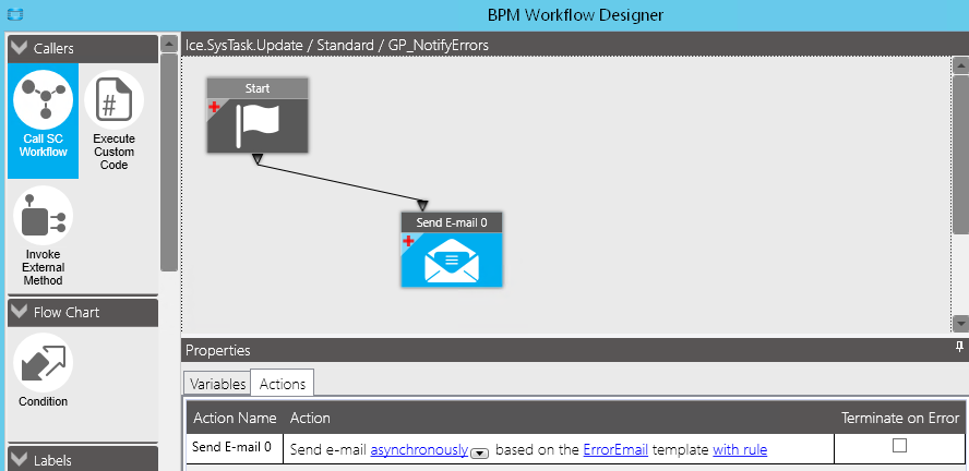

We’re on Epicor 10.1.500.8
When any systask (e.g. GL report returns no records, journal entry goes to Review Journal) returns a status of “Error” instead of “Complete”, I’d like the user who submitted the task to get an email notification.
Placing a “Send Email” Data Directive on the SysTask table results in an email only being sent when a systask completes successfully.
No email is triggered when a systask errors.
Even when I have a straight “Send Email” with no Condition as pictured below, which SHOULD result in an email being sent every time a systask occurs, I’m only getting the emails when a systask ends in a status of COMPLETE.
Any ideas?
Thanks!

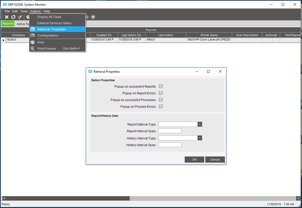

First, do you know that you can turn on windows notifications that will tell you when a report completes or errors? Super helpful. This is set per user. In my opinion, this is a better option because I am always trying to fight a bloated inbox. It makes me miss important things.

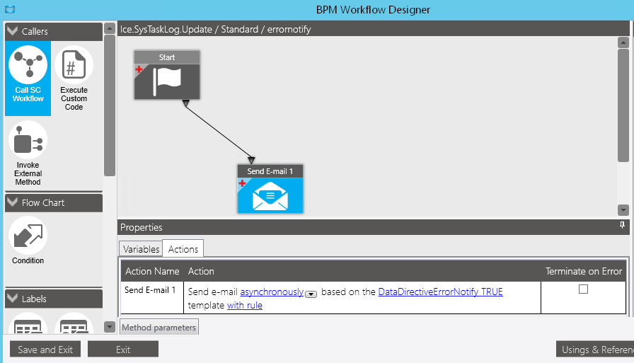

Hi Daryl, same result with the SysTaskLog table. I have a very straightforward BPM on the SysTaskLog table and I’m not getting any emails when a systask errors.
Back to Brandon’s comments then, because you probably need to look at your set-up. We have had BPMs working on this table though I haven’t used it for emails.

Yes, I’m aware of the notification setting in System Monitor. It doesn’t work for us. I think it has something to do with us accessing Epicor from an EMS server through Parallels. We had months of back and forth with EMS about it to no avail.
Plus, I’d rather do the email notification method. I want IT to be copied on the emails. Also pop-ups can/will be missed if someone walks away from their desk after submitting a task.

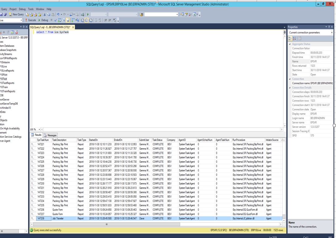

i have done a simple and straight forward test on my Epicor Test environment, standard data directive on SysTask conditioned on task status should work fine, for my testing purpose i have used “COMPLETE” in yours may use “ERROR”

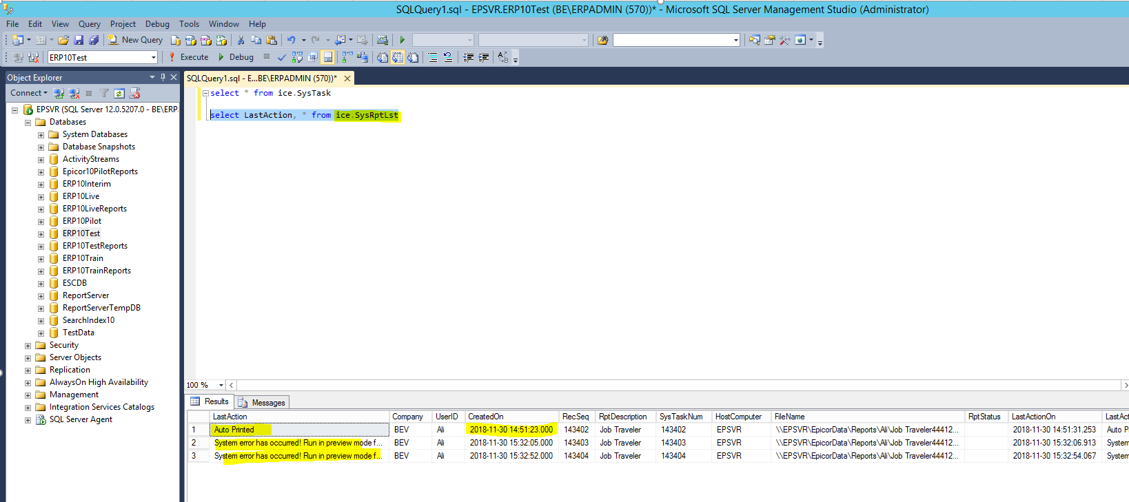

ok Gary,
our Epicor has no financial setup nor Sales pick list, so i run my job traveller report after changing the report server path to error it out, and this is what i found, the created record stuck on a different table called ice.SysRptLst and does not move to SysTask, this could be the reason, so i suggest to move your DD BPM to that table and check, however there is no task status there to trigger your BPM, but there is field called last action i am not sure if you can utilize it or not, try to error any of your targeted tasks and use this field value and see, i know it is not consistent until we know all possible values for all our targeted tasks, but it is a start point
