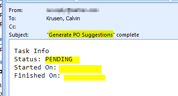

Hmmm … I just tested something last night and I got an email for Status = “PENDING”
Here’s the email. The highlighted fields are inserted Field Queries

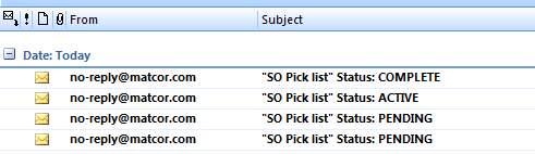

And it looks like I only get emails for the TaskStatus equal to PENDING, ACTIVE, and COMPLETE
Granted I might have an error in my DD.
I’d think the the TaskStatus of ERROR should work, as I see it in the SysTask table when viewed as a BAQ. So it’s not like a SysTask record never exists with the status ERROR
EDIT
The bottom email was for a report that resulted in an error (no records selected). I got the PENDING, but no ACTIVE or ERROR
