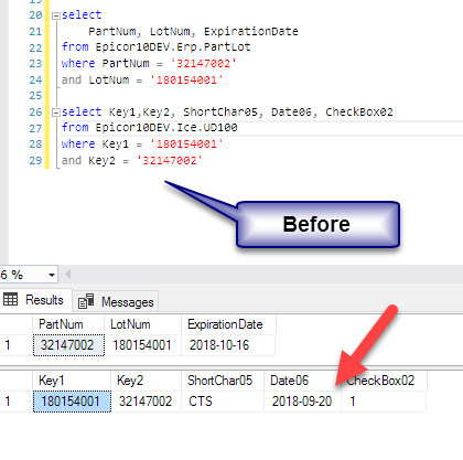

I am using the LotSelectUpdate service inside a BPM. I am setting the PartLot.ExpirationDate field inside the code, but it’s not actually setting it. I am getting though the entire code as shown by my messages, but the record doesn’t update.

Before:
During:
After:
As you can see, it processed all the code but didn’t update the field. I am able to update the field using the BL Tester and the Update method and it works fine.
What’s going on?
