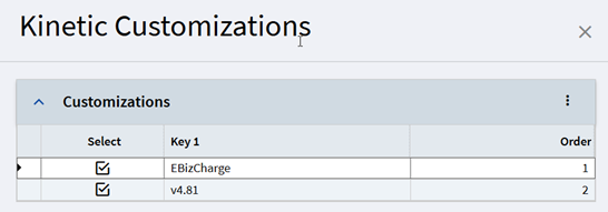

With ours I set our layer as 1st then ebiz layer as 2nd.
I’d open the ebiz only layer in App Studio and evaluate the events they’ve modified to see if any match ones you’re using.
How? It seems to force alphabetical order no matter how I select them
In Menu Maintenance and sorry I had it backward, ebiz is 1 and ours is 2
Bah, order didn’t seem to make a difference.

They kinda are, it’s a matter of using dev console and watching the events and sometimes looking at each layer separately. The layer number does matter, we add our version number to the layer and if ebiz is loaded second it shows their version instead.

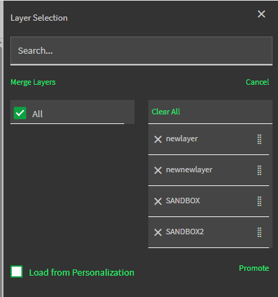

One thing you could try to resolve this case is to Merge Layers in AppStudio. There you can for sure force precidence. Higher on the list takes precidence on conflict.
Then troubleshoot the new merged layer to fix the dataview issue.
Maybe that’ll resolve the auto-merge or maybe it’ll be a throw away layer that at least shows you the merged result to resolve a conflict.
For example, merge layers ebiz and yours making yours on top, then Save Layer and give it a name. This will result in a new merged layer and leave the source layers as-is. Now preview this layer and check out the events, etc. Maybe do another merge with ebiz on top.
I’ve not done this, so if you do, let us know how it goes.
It’d be cool if they’d show a Version Compare across layers.
I merged them. No errors. I tested, no error. But my event clearly didn’t run.

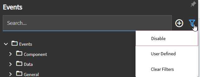

In the mean time, they said open their layer in a different tab, filter events to see what they have added. This way you can refer to what they have used as you are working.
For each system event before/after they have used, they made their own event named similarly that passes on the event to their functions. In your event, you can make the trigger or event next call these functions. Mario pointed out there is no need to merge, as the event name is not validated, so it can not exist, and then when the layer is merged on the fly it will work since the event will be added. This means I wouldn’t be able to test from application studio any more, would have to use a menu item.
