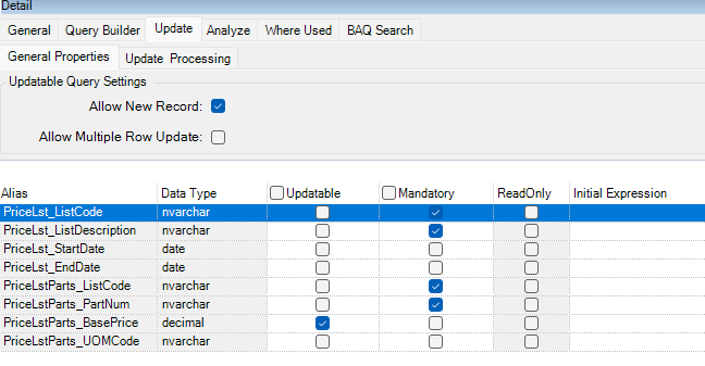

Okay Gurus, I’m trying to create an updatable BAQ for Price List updates. I figured I would start with a very basic uBAQ. I only added the PriceLstParts table. I then added the basic fields for ListCode, PartNum, BasePrice and UOMCode. First, I just want to get it to update a field. I chose the BasePrice. I’ve setup uBAQ for part information before with no issue. But, for some reason on this table I keep getting and error message “Update not allowed”.
Severity: Exception, Table: PriceLstParts, Field: , RowID: d5b0d5aa-e209-467b-9b68-28c98ed54e17, Text: Update not allowed.

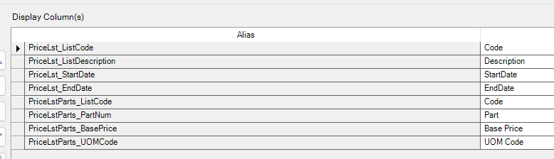

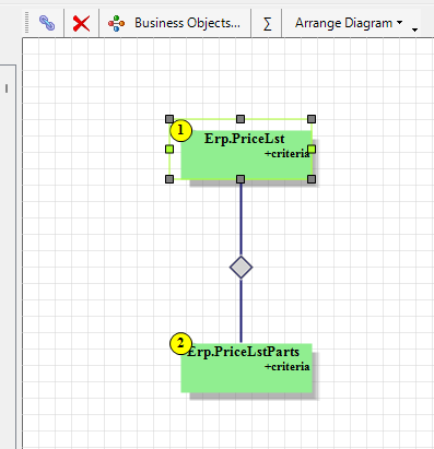

I added the PriceLst table just to see if it would help with resolving the error. I don’t know if it’s necessary to have. The criterial on the PriceLst table was to limit it to one price list and the criteria on the PriceLstParts was to limit it to one item.
Business Object PriceLstParts you selected does not contain update logic, so you cannot use it to update data. Select some other BO.

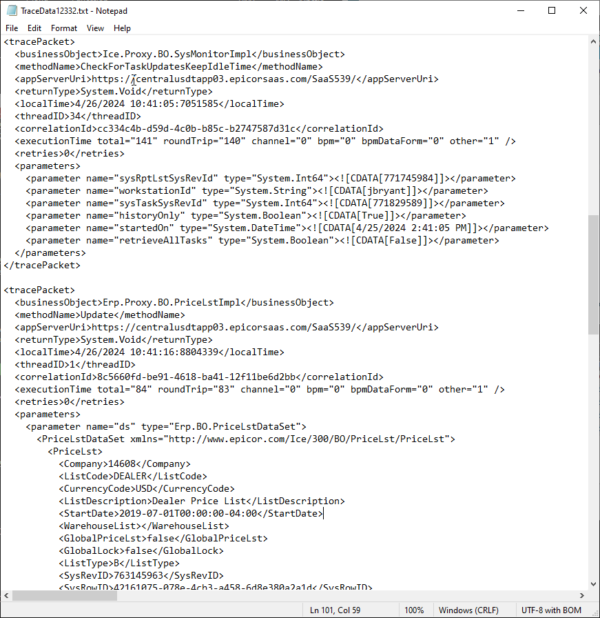

If you do a trace while updating prices, it will show you not only the BO but the correct method and dataset to use to update it.

@Mark_Wonsil this is what I see when I do the trace. (provided I did it correctly)
Erp.Proxy.BO.PriceLstImpl Update https://centralusdtapp03.epicorsaas.com/SaaS539/ System.Void 4/26/2024 10:41:16:8804339 1 8c5660fd-be91-4618-ba41-12f11be6d2bb 0 14608 DEALER USD Dealer Price List 2019-07-01T00:00:00-04:00 false false B 763145963 42161075-078e-4cb3-a458-6d8e380a2a1d false false

As I look at the trace I see:
Erp.BO.PriceLstDataSet
Is this what I’m looking for?
Screenshot of trace.
You can ignore the SystemMonitor BO, that’s just looking for things to print or tell you if jobs ran or not.
But BO.PriceLst is your BO and the Update method shows you what parameters are used and below that shows how the dataset should look.
@Mark_Wonsil you’re the best! that was the ticket!
