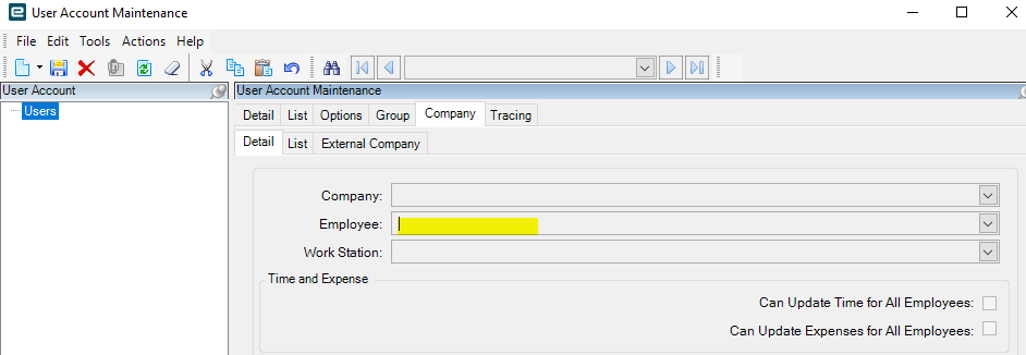

Did you remove the employee link from the Company tab in User Security?
Yes, I did. There isn’t an option to delete (that I could find), so I just cleared out the field and saved it.
That usually fixes that issue in my experience.

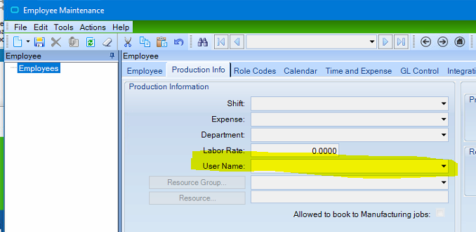

@spkeller I think that is this one in Employee maint.
