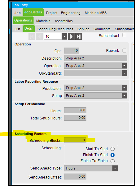

One thing you will need to play with is scheduling blocks. If that does not do what you want, it will definitely move the needle.

You could try changing the scheduling blocks to 1000.
Using the scheduling blocks appears to be my best option so far. But, I have updated it on my resource group and it does not automatically update on the BOO, and it doesn’t pick up the change automatically for scheduling, so I am struggling to find out how to propegate all of the changes down to literally thousands of Methods.
