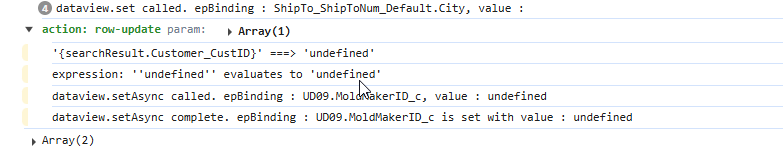

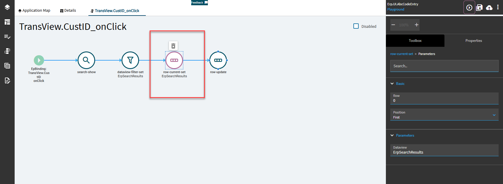

Wow, this was a pain. I finally got it to work, though. I can’t explain why this needs to happen, but use a row-current-set after your filter.
Especially since he’s filtering it down to only (1) row… not sure I get that one. But maybe the dataview filter walks away without ANY row selected?? That is odd.
I mean, it didn’t used to. I’ve used the same method in previous versions, but I was able to replicate the undefined issue in my 2024.1 environment. I had a whole HOST of issues in 2025.1 where it wouldn’t even populate the searchResult table, but that’s another day’s problem.

That’s what I usually use after my search-show.
It does.
The problem @CharlesS is having is because Quick Searches and BAQ searches populate a dataview called ErpSearchResults with the ENTIRE dataset from the BAQ call. Then it makes a secondary call to the normal search service based on a key you selected from the BAQ one, but if you want to access any additional columns from your BAQ dataset, you then have to filter down the ErpSearchResutls table with the result of the searchResult table. It’s a wickedly BAD setup. I still don’t understand why ErpSearchResults isn’t filtered when you select your items in the same way that searchResult is. It makes no sense.

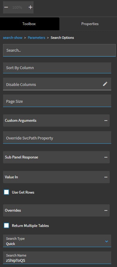

Thank everyone for the help. I finally had to drop back to square one to solve this. It’s a solution in several parts.
  • I created a QuickSearch on Customer.CustID.
    • The BAQ it uses links the Customer and Shipto while hiding the Shiptos with no ShiptoID.
    • I set it to return the SysRowID of the Shipto. This value gets dumped into the SearchResult Dataset under CUSTID that’s important.

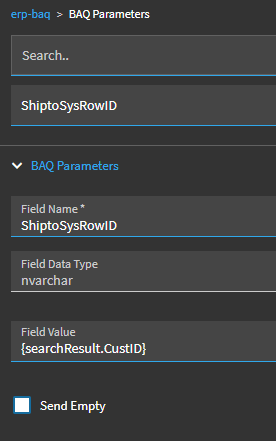

  • I created another BAQ that takes a parameter of ShipTo.SysRowID and returns all the relevant data.
  • Pumping the value from step one into step two VIA a erp-BAQ widget will put all the data into the Result Dataset.

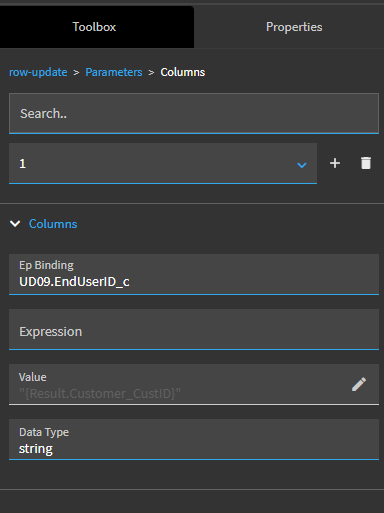

  • From there you use row-update to set the CustID and ShiptoNum with the data from the Result Dataset.
A bit sloppy; but it works. If the Search-Show worked properly I could have done this with two steps.
