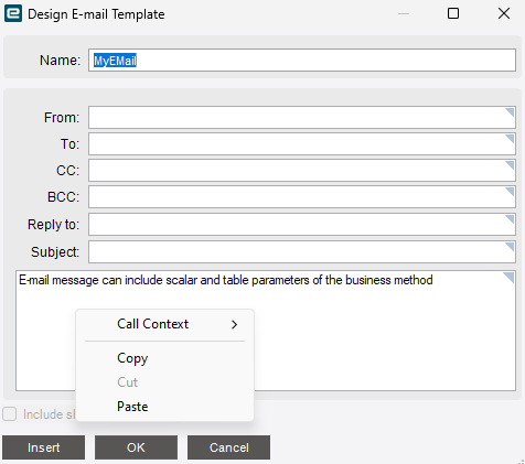

When you open the email template and right click, there are not many choices in there to use (screenshot below).

I’ve not done this exact thing but if you left click on the Insert button do you get Table Query, IIRC that will pull in the value you select as a table

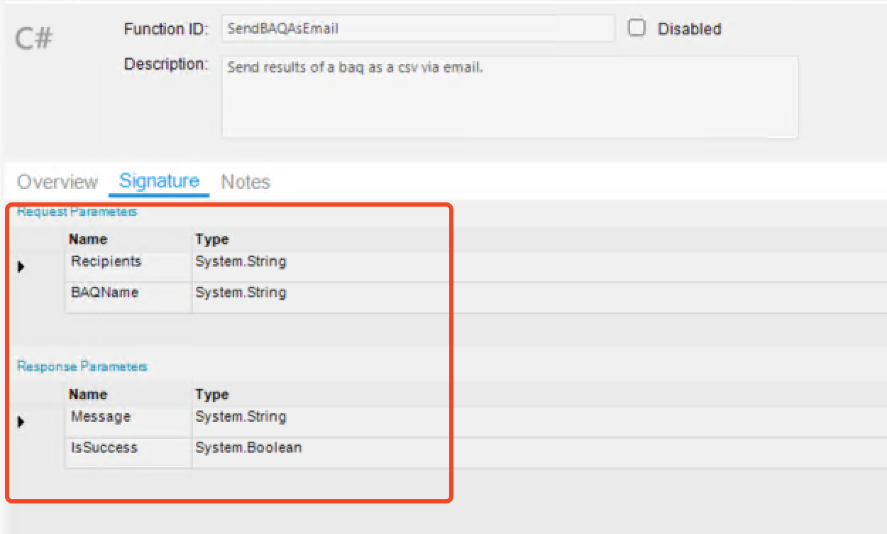

  3. Create a new C# function (name it whatever you want) and add the following parameters (please note that I did not create parameters for FromEmail, Subject, or Body but feel free to add them to make the function more dynamic):

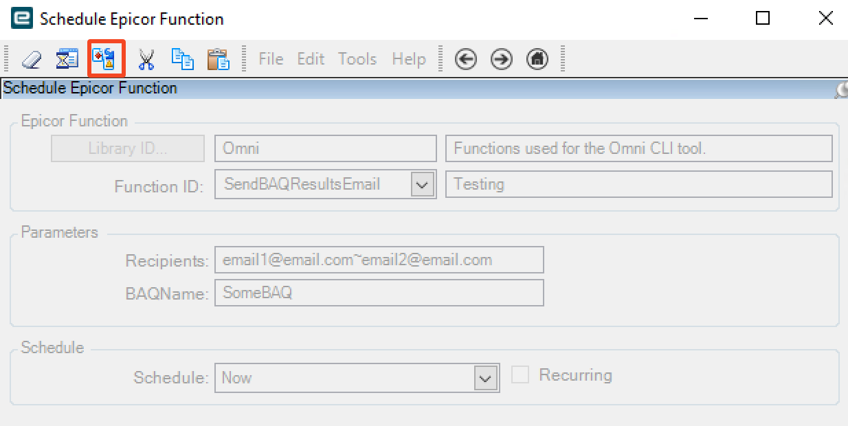

Please note that I wrote this hastily but tested and it does work. It is currently set up to just support a standard BAQ that contains no input parameters so keep that in mind.

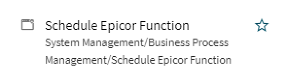

  1. Test the function out by using the “Schedule Epicor Function” menu item:

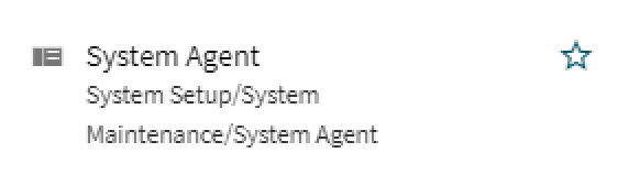

  1. If all works well, just set up a schedule in the System Agent menu and then run that with the recurring checkbox checked.

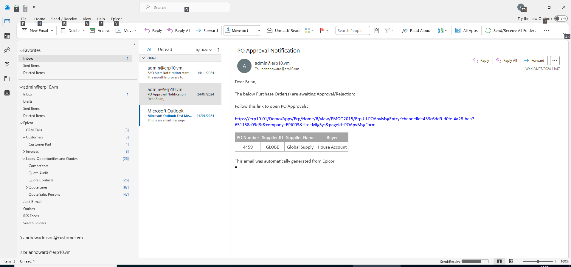

This worked for me.
I did modify it to have the PO numbers show in the body of the email.
That way they don’t have to open the CSV unless they want all the fields.
I really appreciate you putting this together for me. It is awesome!

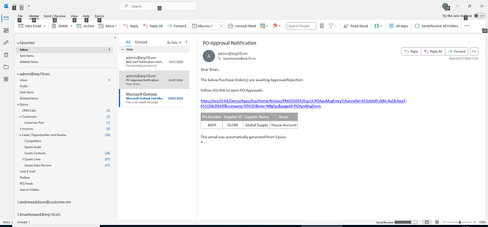

How did you get it to do a table for the information?

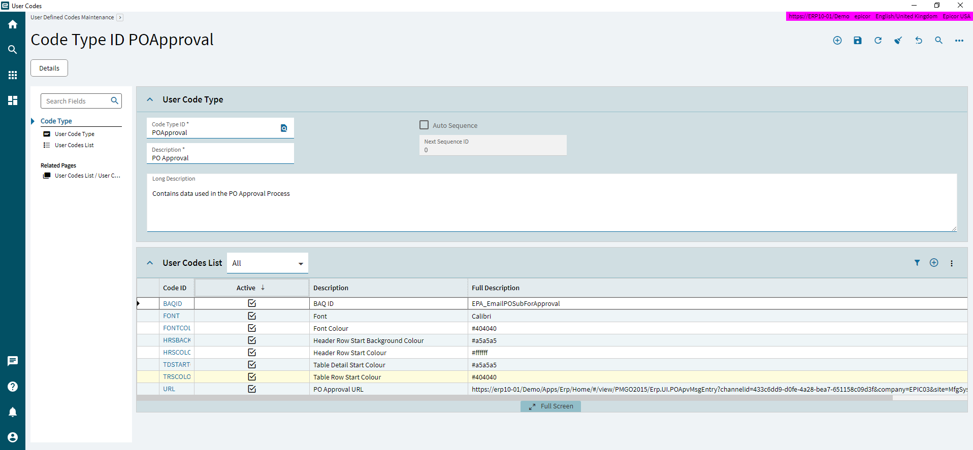

User Codes allow the configuration of various “standard” formatting elements that can be used within the Function, do for example the User Code for the PO Approval Function is setup as follows:

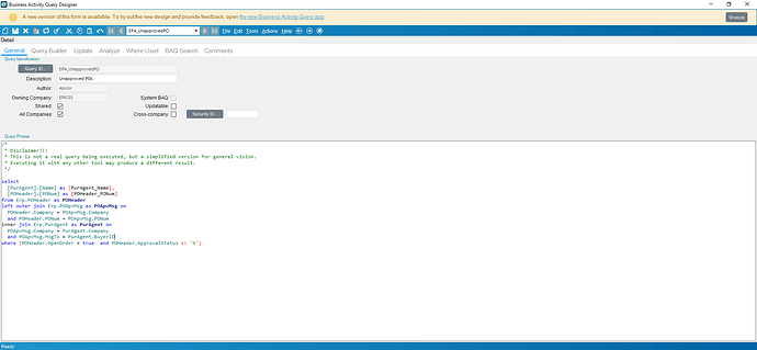

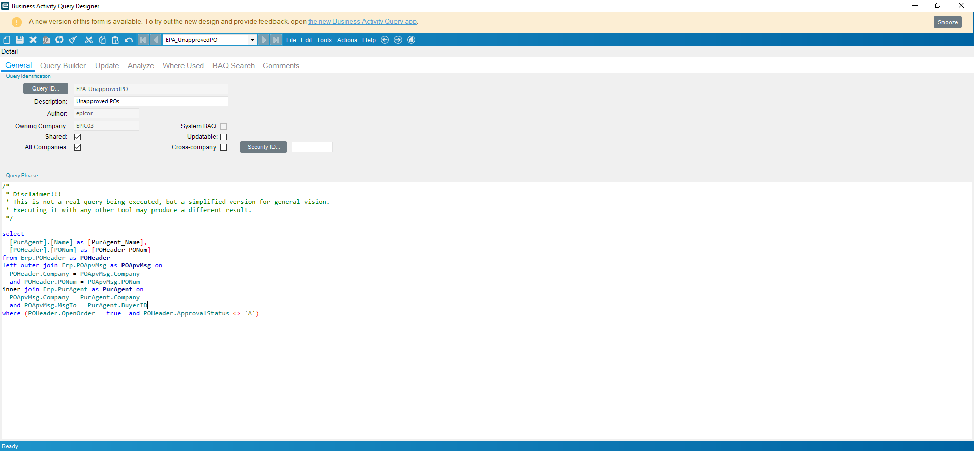

Then I have a BAQ that returns a list of PO’s awaiting approval:
Then within the Function, I invoke the Ice.MailSetting.GetByID BO to get the “from email address” that is part of the company setup and taking that value into a CallContextBPMDataField, next is a Custom Code widget where i call the BAQ, take the results and format the email from the User Codes - here is the custom code:

  select ThisUDCodes))
  callContextBpmData.Character07 = TRSCOLOUR.LongDesc;
  foreach(var TRSCOLOUR in (from ThisUDCodes in Db.UDCodes.With(LockHint.UpdLock) where
  ThisUDCodes.Company == Session.CompanyID &&
  ThisUDCodes.CodeTypeID == "POApproval" &&
  ThisUDCodes.CodeID == "BAQID"
  baqID = TRSCOLOUR.LongDesc;
