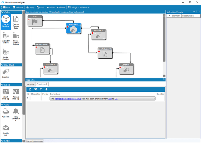

Here is a snapshot of the BPM:
The first condition checks to see if the Expense Status goes to “A” and then processes the code above. The other condition checks for “R” and does similar logic indicating it is being rejected. In both cases if the sendEmail flag is true it sends an email (or at least it is supposed to).
What could be causing this code to error when it is looping through the ttEmpExpense table?
