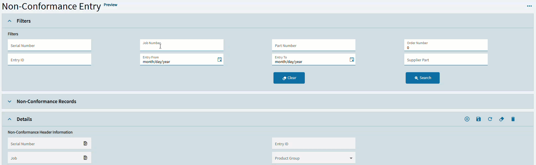

At Insights, I liked the “Taming The Dashboard Dragons of Application Studio” session, and I was intrigued by the way they were setting up their dashboards with the top section for filter criteria (like a classic dashboard tracker), then with “Search” and “Clear” buttons below. “Search” button expands and refreshes the data grid (collapsed on form load by default), and the “Clear” button clears all of the Filter variable values and collapses the data grid (and in my case: clears the dataview as well since this particular dashboard is also doubling as an entry screen with a full “details” section below the data grid that tracks with the selection).
I am in the middle of uplifting a classic dashboard and creating a new Kinetic App from Base to handle everything the old dashboard did and more. Basically a combination of the Classic Dashboard (read only) and the UD02 Entry screen we used as the entry screen for this particular custom process (highly customized classic screen on top of the base UD02 Entry screen, etc.).

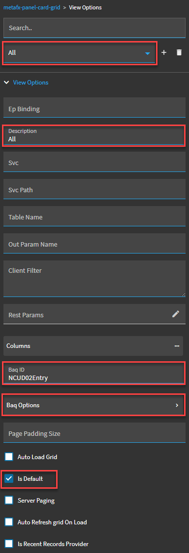

The FIRST View Option (in my case, “All”, ie. no additional filters beyond the dashboard filters at the top of the dashboard), needs to have the Provider Model fully built out using the BAQ ID and BAQ Options → Where List values, and has to have the “Is Default” checkbox value set to true. So in my case it looks like this:

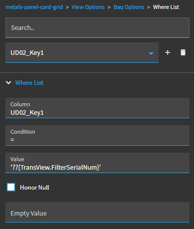

And I have all of my dashboard filter criteria values set up in the BAQ Options → Where List:
(Mine has 8 entries in the where clause list to account for 8 default dashboard filters at the top of the screen)

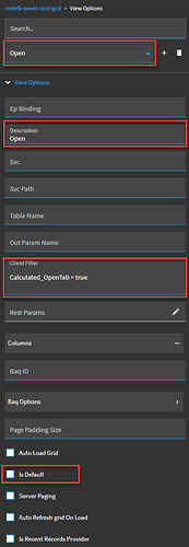

Then, for subsequent View Options, you can simply use the Client Filter where-clause-string to further filter the returned results, at a display level, without having to re-enter all of the original dashboard filters in a separate BAQ Option → Where List on each view.
It looks like this in my case (for 10 subsequent view options beyond my “All” view):

2025-06-03_14-00-21
