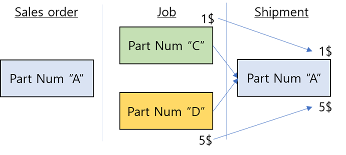

I’ve written something similar to this before. I have a problem with two costs of the same part.(Std cost, one site). The cost differs depending on the outsourcing location.
On this matter, one of the staff came up with the following idea. Can Epicor support this?
  • The sales order is created as part “A”. (The sales team does not know which outsourced production will be made at the time of ordering.)
  • A job is created as a part of the production site.
  • Shipment is created as part of Sales Order. And it is automatically shipped as a part created in the job.
    *Since Epicor doesn’t know if it will process as Part “C” or Part “D”, it sets priority and if the 1st part is out of stock, it will be processed as the 2nd part.

All of our jobs are MTS(Make to Stock).
Part “A”, “C”, and “D” are actually the same product. Parts “C” and “D” are only products manufactured by other subcontractors. So Part “C” and “D” actually cost different. However, since Epicor’s Std cost only allows one cost for one part, we want to use Part"C" and “D” to enter different costs.
The accounting department wants parts with different costs to appear as those costs. Conversely, the sales team wants to put it as Part “A” because it does not know which outsourcing company will produce that part when creating a sale order.
So I came up with this idea. But I don’t think Epicor will support it.
If I treat it as Part"A" in Shipment, I want it to be depleted as Part"C" first, and then as Part"D" when the stock of Part"C" is exhausted (automatically).

My company’s business background is as follows. To help understanding this issue
  • Usually, the delivery of the customer is about a month. However, the raw material supply of the product is about 6 to 10 months. So we have to make it in advance.(Make to Stock). So we couldn’t even use MRP. We made a forecast and entered Forecast/MPS, but it wasn’t too accurate.
  • We are producing the same product from two outsourced companies, and my accounting department wants to appear separately in the inventory report because the Std cost is different.
  • So we also considered generating part numbers per outsourced, but the sales team was against this method. This is because the sales team does not know which outsourced products will be shipped when entering sales power/sales orders. After the FG to be shipped is confirmed, the sales team must frequently make corrections.
  • So, we are thinking about alternatives that satisfy the needs of the accounting team without affecting the Salesforce/Sales order input of the sales team.
OK, that helps.
So, first, Sales always wins, and that’s fine; they pay the bills. So sales order is for part A every time, and I would agree with that anyway. So we start there.
Second, you have C and D (and I hope these are indeed two different part numbers separate from A). These need to be stocked.
So now you need a way to turn C or D into A. That’s a job.
Now, understand that a job does not need to correlate to anything physical. The process to make C might be a job, but that’s not what I am talking about. After C is done (made, bought, whatever) and received to stock, you make another job to turn it into A.
I’d suggest that A is a non-stock part and thus made to order (as it’s really a placeholder for C or D). So you only complete the jobs for A as needed (and at that point you’d use up C or D, similar to shipping those parts).
Then you’d see the variances in the jobs and could even trace them to their sales orders if needed.
Yes, it’s work and takes some management (hello, dashboards!) but this is what you are dealing with.
