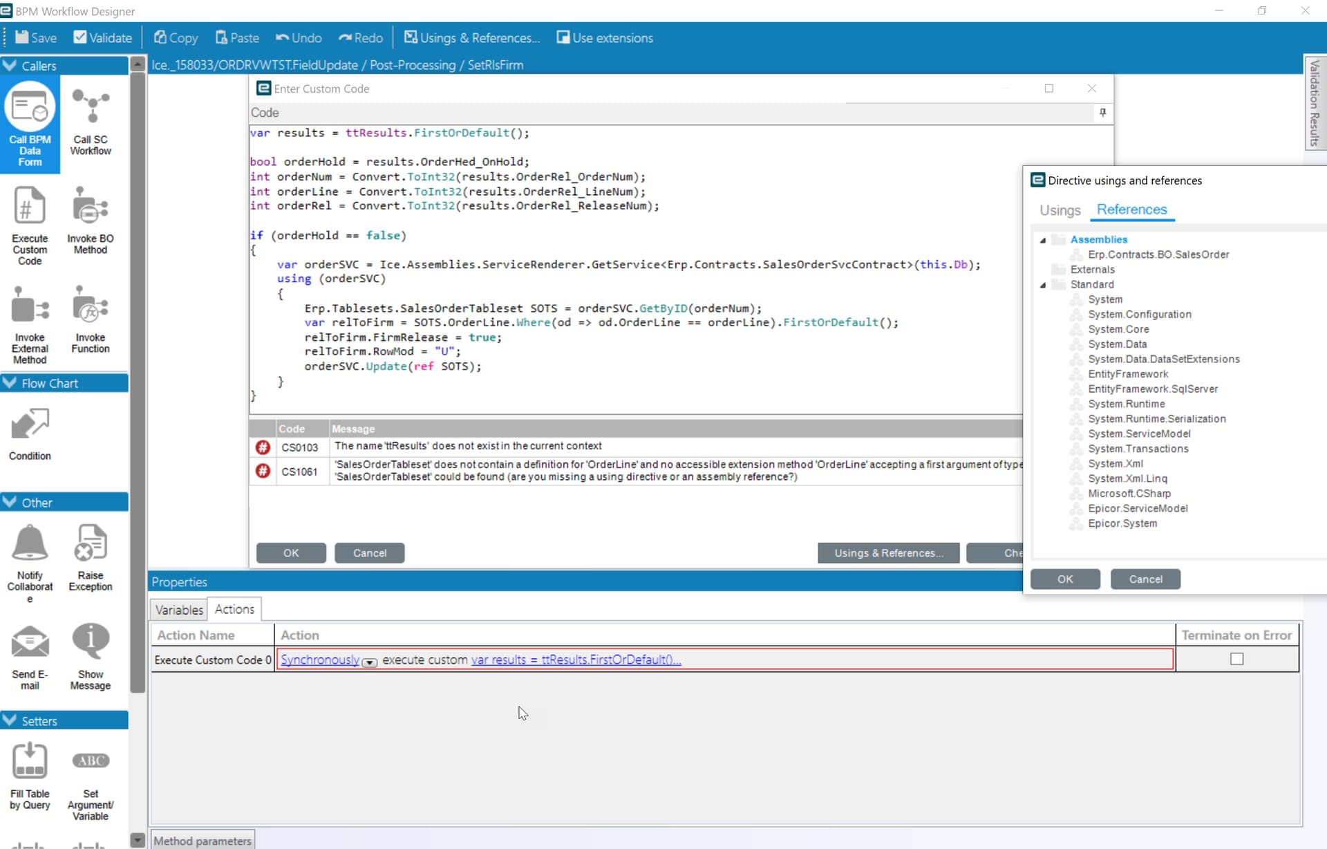

I am trying to reverse engineer a BPM as a learning exercise and I am having a little trouble.
I am trying to re-work an uBAQ+Post Processing Directive and Dashboard it so it sets all order releases (orderrel.firmrelease) to True when an order is taken off hold (orderhed.orderheld = False) from an updateable DB.
I am having trouble wrapping my head around how the data/table set is created, pulled in and updated. I also don’t know why I am getting the ttresult error, it’s strange, in the bpm queries there are no ttresults to work with either, just DataSets (ds.) Maybe something to do with newer versions of E10/Kinetic.
I am pasting what I worked through below to see if you can give me some guidance… most will probably be able to tell what i was trying to do from the example…
Anyway, let me know if anyone has any thoughts or guidance.
var results = ttResults.FirstOrDefault();
bool orderHold = results.OrderHed_OnHold;
int orderNum = Convert.ToInt32(results.OrderRel_OrderNum);
int orderLine = Convert.ToInt32(results.OrderRel_LineNum);
int orderRel = Convert.ToInt32(results.OrderRel_ReleaseNum);
if (orderHold == false)
    var orderSVC = Ice.Assemblies.ServiceRenderer.GetService<Erp.Contracts.SalesOrderSvcContract>(this.Db);
    using (orderSVC)
        Erp.Tablesets.SalesOrderTableset SOTS = orderSVC.GetByID(orderNum);
        var relToFirm = SOTS.OrderRel.Where(od => (od.OrderLine == orderLine) && (od.OrderRel == orderRel)).FirstOrDefault();
        relToFirm.FirmRelease = true;
        relToFirm.RowMod = "U";
        orderSVC.Update(ref SOTS);
