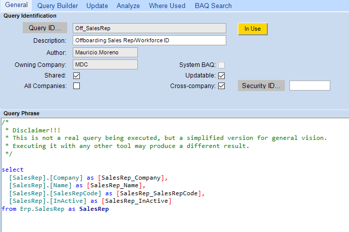

Check to be sure that the BAQ has both “Cross Company” AND “All Companies” selected.

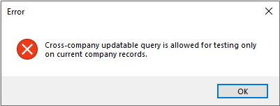

done already but Epicor keeps saying that I can’t update records from a different company from the one I’m currently logged in.

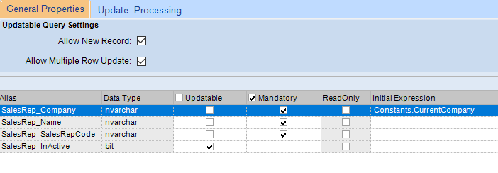

I have an updateable baq that works cross company so I know its possible, maybe put screenshots of your BAQ?
does your BAQ include the Company field(s) in the table(s) you’re displaying?

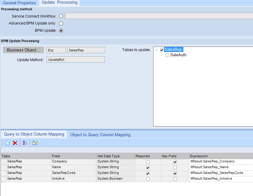

Mine is not an updateext method. I wonder if that makes a difference.
