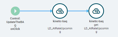

I have a updateable BAQ inside of a kinetic dashboard, its only job is to toggle a check box UD field. My grid pulls in the BAQ and updates the dataview, then to actually update the field I have a normal kinetic-baq update event followed by a baq get:

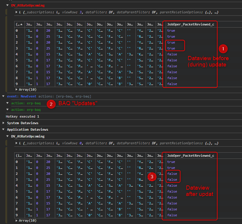

Sometimes the table updates fine, and sometimes it just decides not to. When it doesn’t work, it still calls the erp-baq event - just doesn’t update.
Any ideas what could be happening here? I thought maybe it was a dataview issue but my dataview seems to be fine. The payload also looks the exact same when it works vs when it doesn’t, so I’m pretty lost on what to look for

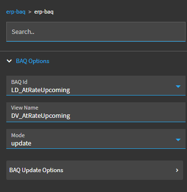

Fields are updated from an update button on a panel card grid, which calls a kinetic-baq “update” event:
Rowmod is “U” for the changed row(s), null for an unchanged row
Network call looks fine to me, it’s successfully sending all of the rows in my dataview. The first call doesn’t successfully update the table, but the second one does. Maybe this is just an Epicor issue?
