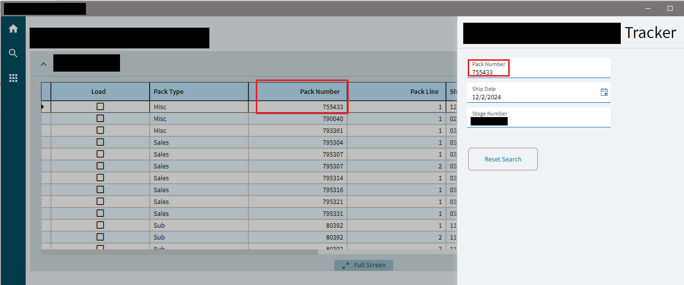

After removing the customized tracker and replacing it with the default tracker and generating the application, I noticed a strange occurrence with the filters.
When the dashboard finished retrieving records, the filters of the tracker populated with data from the returned results of the UBAQ. Even after removing them from the slide out panel and placing them on a separate panel card like what is shown in the post above, the issue persisted.

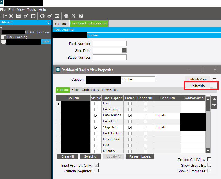

That was handled by the Input Prompts Only in your classic screenshot.
Is that also set in the new version?
I did assure to have that checked prior to generating the application. I just double checked and re-generated the app and the issue still persists :frowning_face: . However, I did generate the application through the classic “Dashboard” screen. I don’t appear to have access to the Kinetic iteration of said screen, has it been published by Epicor in future versions? Currently we are on 2024.1.21.
