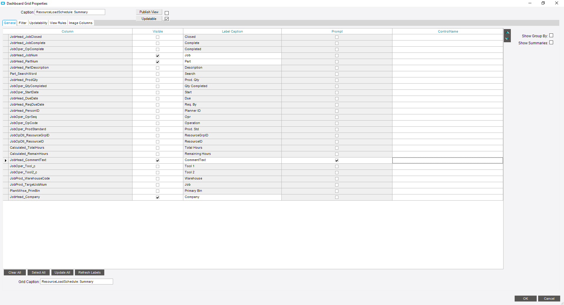

We have a custom field in the JobHead table, which is basically just some planning notes.
I would like to be able to update this field from a dashboard. My BAQ has a list of job numbers with columns for customer part, quantity completed, etc. When I make it updateable, it automatically checks off the JobAsmbl and JobOper tables (using JonEntry for BO). I don’t need to update those, so I unchecked them for simplicity. I have been using the ICE Tools User Guide but I am getting a whole bunch of errors.
Anyone know what I am doing wrong?

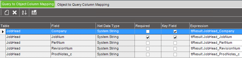

In your screen shot for Object to Query Column Mapping"
the row for JobHead_ProdNotes_c
column .Net Data Type
I wonder why the value “System.String” is followed by a question mark?

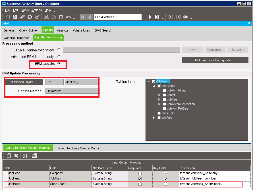

Ref screen shot of Update Processing sheet…
BTW… when things are auto-selected after I choose the BO. Unchecking things tends to bring up Errors similar to your screen shot. If it is the correct BO, I just leave them & then in the related dashboard, I don’t display any unneeded fields.
