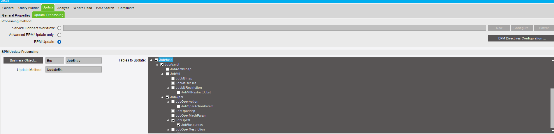

I am trying to create a UBAQ for the JobOptDtl table. I want to have it so the user can update the ResourceID and the CapabilityID, however when I set these to be updatable and connect the jobEntry business object, it is not allowing me to update these fields. When I change the field and press update it looks as though it saves, but when I run the query again my changes are gone.

I’ve just got this functioning in an updateable BAQ. Currently trying to get the dashboard functioning. I did have to do an advanced BPM to get this functioning but we have prevent changes enabled. You may need to autofill your audit log if you have that enabled. The only other thing that would be stopping it is prevent changes. Going the advanced BPM route took awhile. Here is a snippet from the code. Should be able to add jobhead.changedescription and fill using constants without using advanced bpm.
        // Step 2: Re-engineer & Re-release
        ds = new Erp.Tablesets.UpdExtJobEntryTableset();
        ds.JobHead.Add(new Erp.Tablesets.JobHeadRow
            ChangeDescription = $"Re-engineered & re-released by {Constants.UserID} -- Change made via Scheduling Dashboard",
            Company           = Constants.CurrentCompany,
            JobNum            = ttResult.JobHead_JobNum,
            JobEngineered     = true,
            JobReleased       = true,
            RowMod            = "U"
