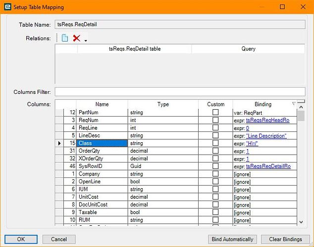

I have a form that lists chemicals that are set to expire in the next 90 days. To this dashboard, I added a blank tracker form. I opened the form in customization mode, and added a button to the tracker form. My goal is to have the button pull the part number from the grid’s selected row, and pass that part number into a callcontext field. Once that is done I want my UBAQ custom action to run. My custom action is designed to generate a new requisition head, and detail.
I think the req head is created ok, as I can see a list of the reqs my UBAQ created as I am testing. However the req detail, or req line is not getting created correctly. Instead my BPM gives this error: Requisition for Other is not allowed for a Quantity Bearing Part.

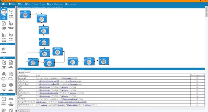

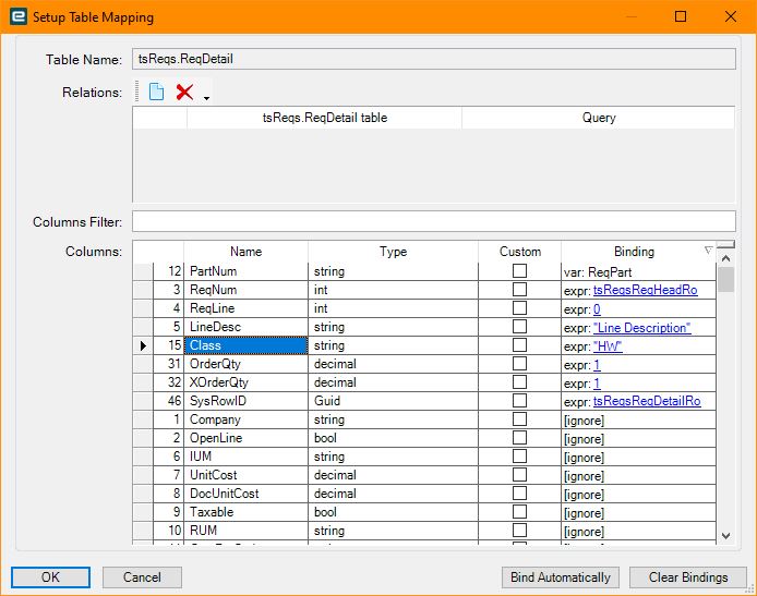

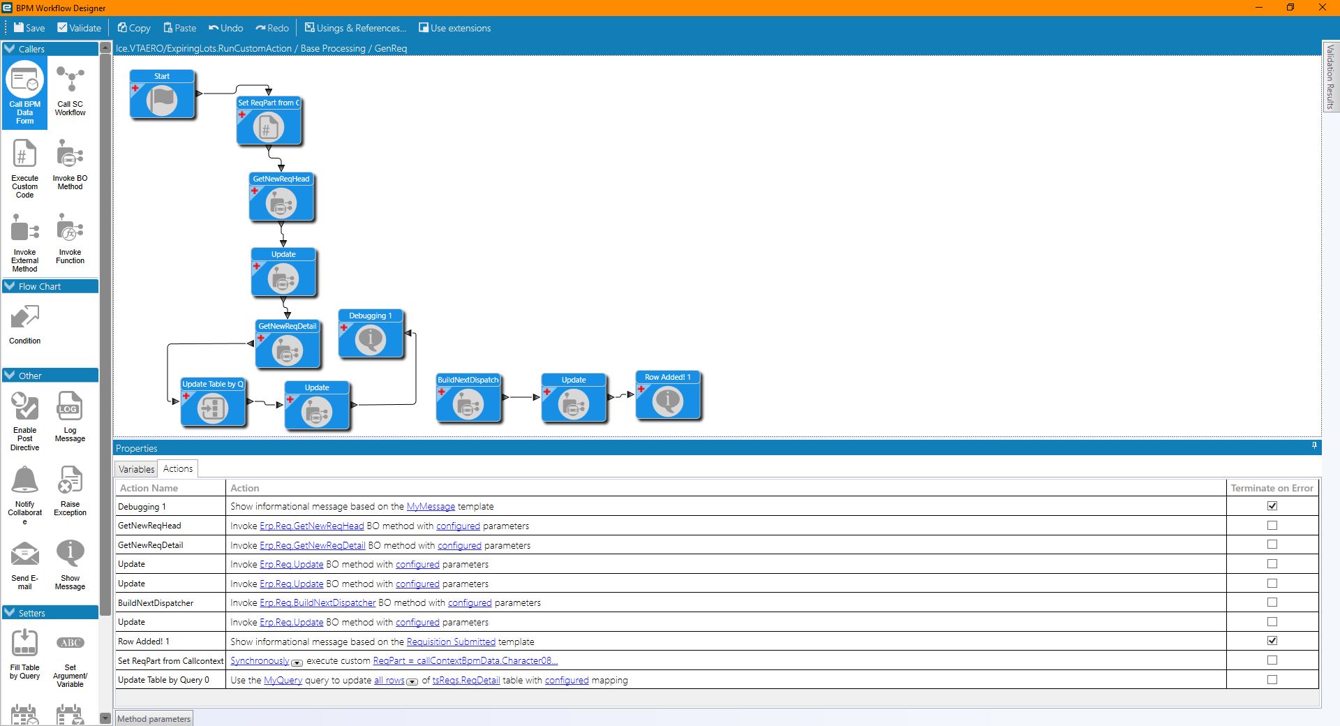

I am using BO method widgets to duplicate the methods I traced from manually creating a requisition and detail line.
I know that I can manually create a req head and line for the part in question. I don’t get any such error when I create it manually.
Has anyone seen this error before? I assume that I am missing something when I setup my requisition line.
