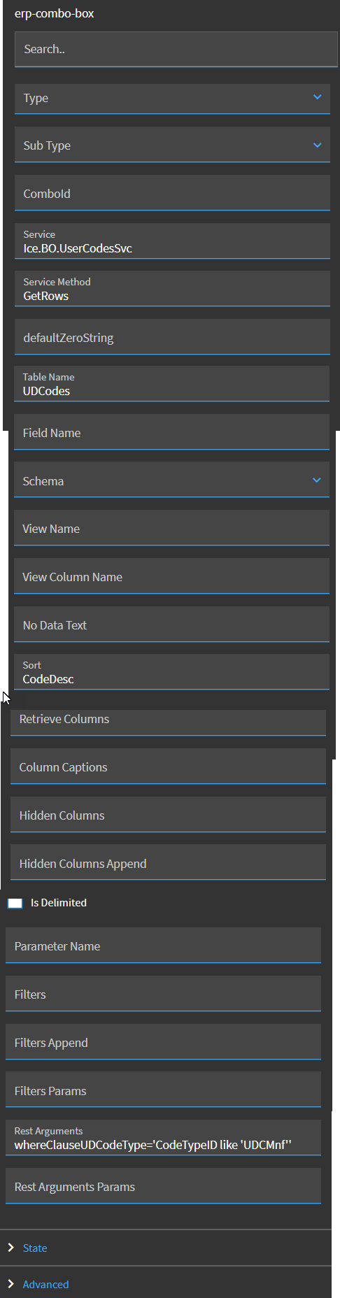

I have a ComboBox on my layer that links to User Codes, this is all working great. I now have a record with an entry in the UD field, but I want to be able to clear the entry and leave the UD Field blank. I can’t quite see how to make this happen with my configuration.
Notes:
User Codes table
ComboBox on Part Entry screen

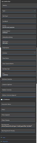

Check image for details on the APplication Studio ComboBox
If I’m following, you’re saying you set this combo box up and its working fine. Issue is you have a record that has something in this field currently and you want it to be null. You should be able to tab or click into the box and just hit delete/backspace and then save.
That was the obvious thing we attempted, but to no avail. I am stuck in the selections in the list.
I attempted to add an empty value in the User Codes but User Codes will not let me leave an empty value or even a {space}.
FYI I am not sure this is a huge issue, just feel like there is likely an easy answer I am missing.
We do rely on the UD data to drive selections in Epicor CPQ, but we could just as easily create like a “None” selection and filter it out in Epicor CPQ. One of those things I can’t help but feel I must be missing something obvious.
Figured this one out finally. @TDray was right, but I had the field as “DropDownList” so users could not delete the content, I have now changed the field to “DropDown” and they can delete whats in there, YAY!
