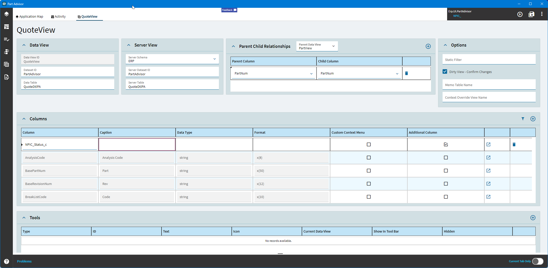

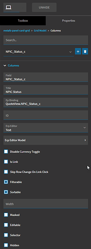

However, I’m running into an issue with the Part Advisor form (Erp.UI.PartAdvisor). Since this dashboard uses multiple views, I used Application Studio to add the UD field to each relevant view.
Here’s what I’ve done:

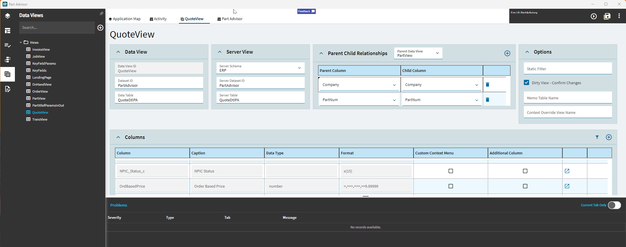

  • Added the field to each view that’s connected to PartView via the PartNum
  • Note: all views except PartView are grid-based
  • Confirmed that the field appears correctly in preview mode

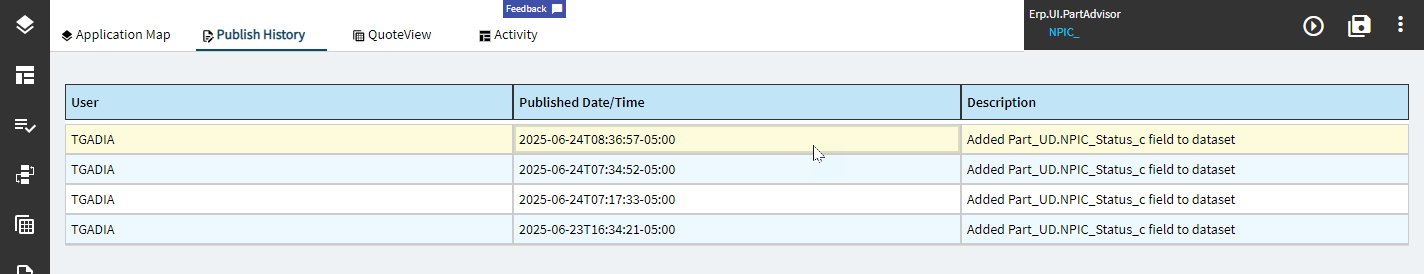

  • Publish History shows the changes published successfully — no errors or failures
Despite all this, the field does not appear in the live UI.

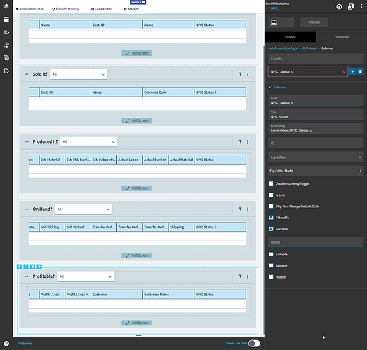

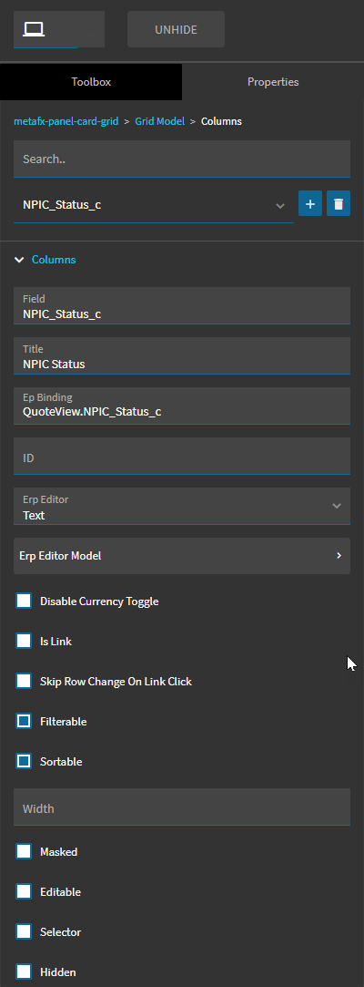

I’ve included screenshots to show how the field is configured in Application Studio, the publish history, and the binding setup.
Has anyone else experienced this issue? Is there another step required to get the fields to appear in the grid views of a dashboard after publishing?

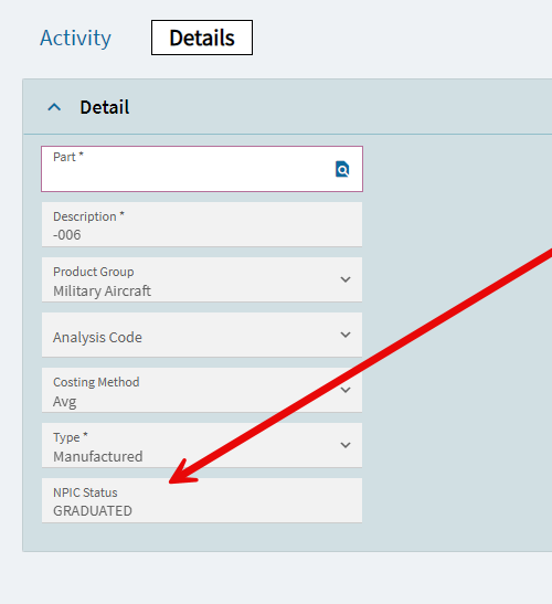

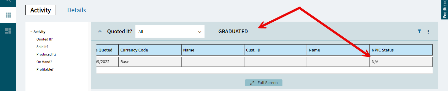

I have been tasked with adding our new custom fields to all of our Part -related forms. The issue i am having is with Part Advisor. I can get the field to show up on the Details screen that is liked to the partview dataset where the field lives.
I can also get the value to show up on one of the activity screens IF i post it as a label. However, I need to post it as a part of the grid’s dataset.

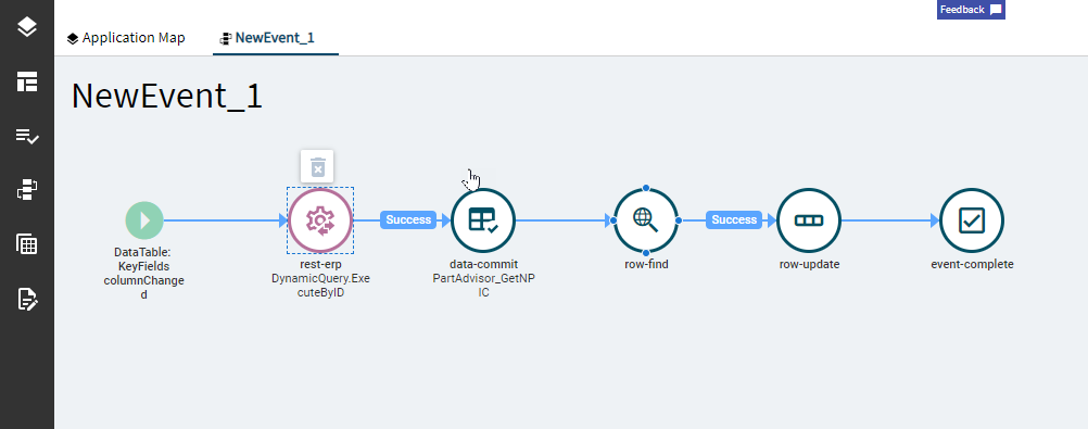

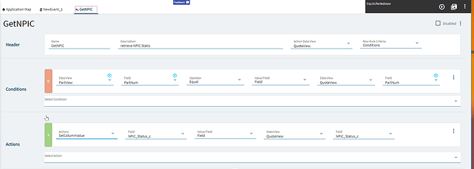

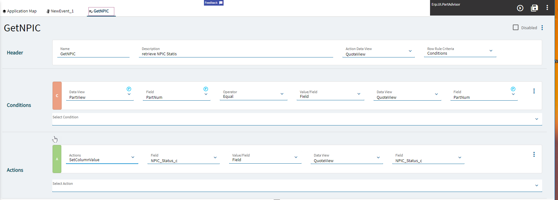

I created a new view and linked it to that BAQ. Then I tried to bind the fields to that instead of their natural view and/or partview.
To do this I tried to create an event that triggered the baq execution via Ice.BO.DynamicQuerySVC.ExecuteByID, committing that dataset to the view i created, finding the row in quoteView (or any other view under activity) and bound it to the new view via row update. This was also not successful. I did test the call in epicor’s rest help sight and it does produce values.
  • I also tried to create rule that would trigger an update of the fieldvalue whenever partview.partnum changes. This also did not produce results.
Each view does have the field in their dataset, but the values are showing up as the default, not the correct Part field.
