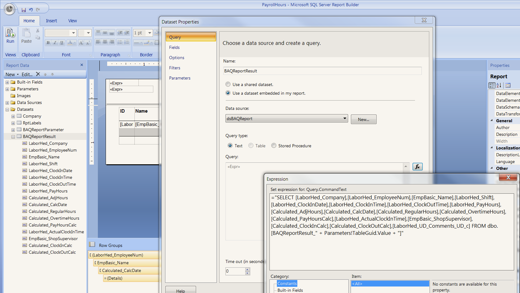

I’m trying to add a UD field that I’ve added to the LaborHed table. When I add it as [LaborHed_Comments_UD_c] in my BAQReportResults expression and try to run it, I get a generic error. Is there a proper way to add a UD field for BAQ reports?
more details on your error would help, you included the new field in your BAQ right?
I did add the field, yes. The error was an unspecified generic error. However, I’ve worked around the issue by creating a calculated field that just pulls that field in. I’m not sure what was causing the issue exactly but it works with the calculated field now.
that was going to be my next question was if you added the field to the rdl next but i wasn’t sure when you got the error.
I added it to the baq and the BAQReportDataset expression (i think that’s the name, I just closed everything) and field/label. I also tried left joining the UD table itself in the expression but no luck. This work around seems good enough with no real performance hit.
