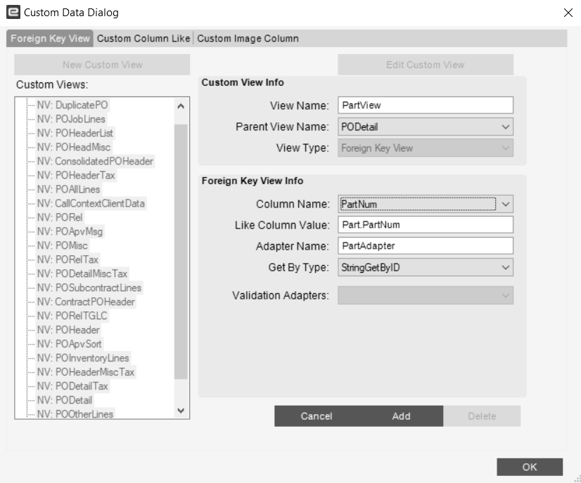

In your version, on the customization, you can add a Foreign Key View.
Tools > Data Tools
Click “New Custom View”
Give a View Name (I would use PartView)
Select PODetail from the Parent View Name
Select Column Name of PartNum
Click Add
Click OK

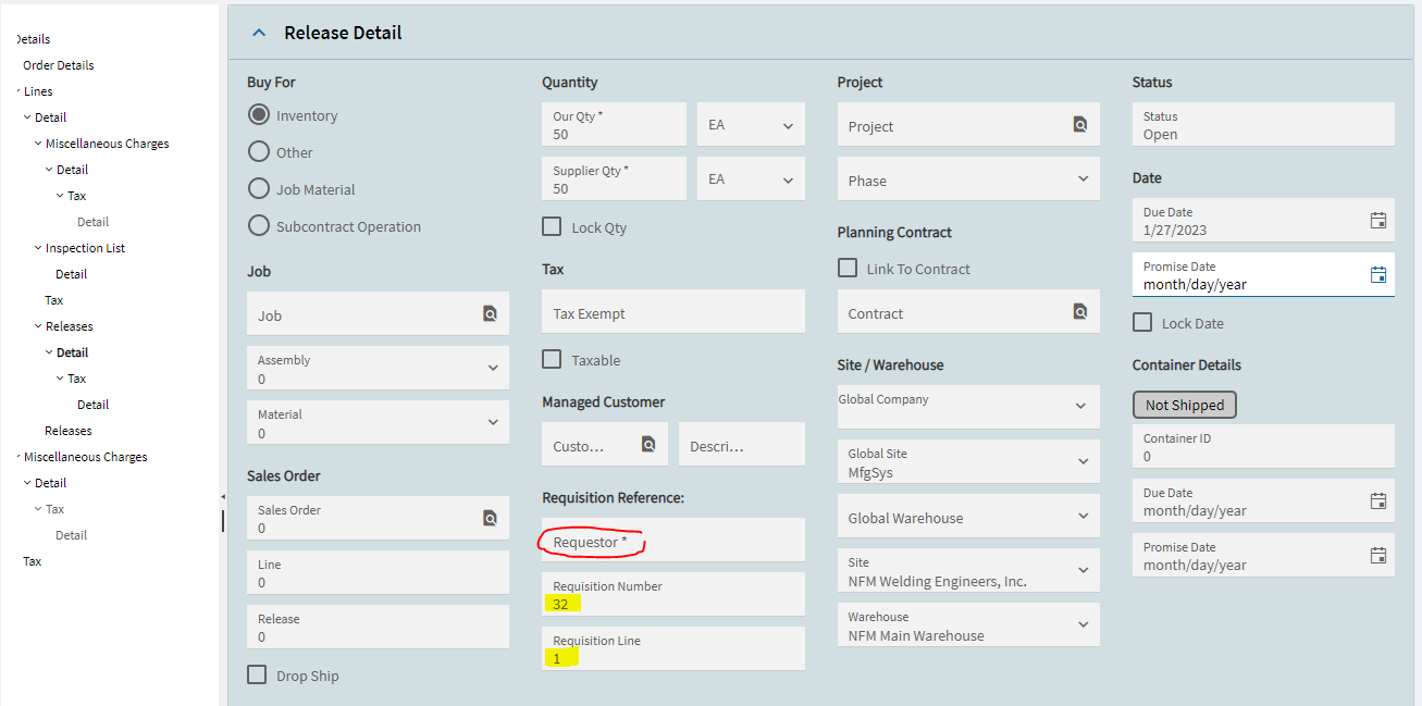

ANOTHER alternative… you could possibly forgo the BAQ & BAQ dataview and add the native Part dataview into PO Entry. The Part Dataview should already include your new UD column. But, here again, you still need to create an event to populate that dataview. You would just use a rest-erp instead of an erp-baq event widget. I did something similar in the below post. I wanted to get Requisition information (the name of the person requisitioning) visible on the PORelease Detail. So, the steps would be similar.

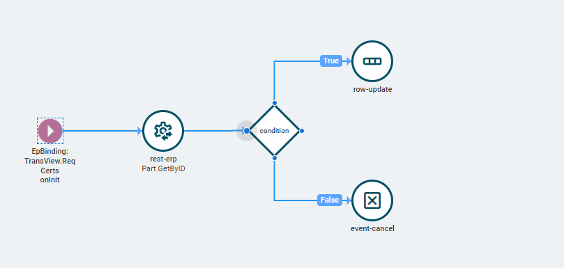

I just wanted to report back in. I was able to use the information in David’s other post to get this field populated, so thank you David. It is working great except for one minor thing. If the purchasing agent clicks on the line Details tab before adding the part number to the line, I get an error that the parameter partNum is not found in the input object. Since my buyers very rarely enter a PO manually, this is not really an issue, but for my own sake, I’d like to know why. The event is set to fire on the text box for my UD field, so I’m not sure why it would fire when clicking on the details button to add a line item. Any ideas?
The last post in the chain I added up above may help… I had a similar issue where I would get an error and @hmwillett provided the below, which worked for me.
In my case, I added a condition looking for a PORel.ReqNum. If ReqNum = 0, then I just set my Requisitioner’s name to “” (empty). This got rid of the error I was getting.
If the ReqNum wasn’t zero, then it would run my REST call and pull in my data.

I have a condition in my event that comes after the REST call to make sure the record has a requirement in that field. Should this happen before the REST call instead of after?
Its a timing issue. You need your event to fire AFTER a PartNum exists on a line so there is something to pass with your rest call.
Right now, your event is currently firing onInit of TransView.ReqCerts… I’m not sure when that is happening… but it could be when the Line Details page opens.

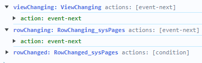

If I create a new PO and click on Line/Details, I see these events fire.
Your textbox must be being “initiated” when that form loads. So it does a rest call and fails, causing the error.
If I add a new Line and add a PartNum, the last event that fires is:
columnChanged_PODetail_PartNum
If I toggle between existing lines, the events that fire are rowChange events… I don’t see an event in common to tie your event “after”.
You MIGHT need to make your current custom event have no trigger.
Then create a new event that fires after columnChanged_PODetail_PartNum and calls your existing event with an event-next (to handle the problem scenario).
Then create another new event that fires after the rowChange event (to handle toggling through PO Lines) which again would call your original event with an event-next. That way your rest call would occur every time the user navigates to a different line.
