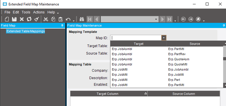

Well, yes and no. There is a command that maps UD fields from one table to another during GetDetails. The name changes slightly across different versions but in 10.1.600 it’s called:
Unfortunately, there isn’t a map from JobHead to any other table. :person_shrugging: Maybe there’s a way to add a map but I have not tried to do so. But certainly, you could do a Method Directive on GetDetails and do the mapping yourself.

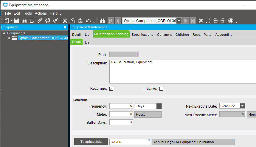

I’m using Maintenance Planning to create the jobs:

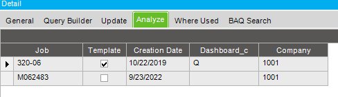

However, it is not copying the UD field:
If it’s not copying this field, I don’t think it will copy another UD field that I add for a boolean to copy or not copy the ud field. Therefore, I can’t see that UD field triggering the DD. If I could somehow link back to which job it is being created from, I could easily grab the field and copy it, the problem being how to determine if the job when created came from a template, and then which one it came from.
