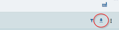

Yes they did fix it:
You have to toggle this to download all the results and then the filters should be enabled. I don’t know if you aren’t all the way to the right on your screenshot, or it doesn’t show because you are previewing the layer?
