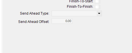

I’ve added two UD fields to the classic job entry form, but they are not showing on the form. It shows up on the form when I go into developer mode and select the layer just not when I navigate to the page through the menu.

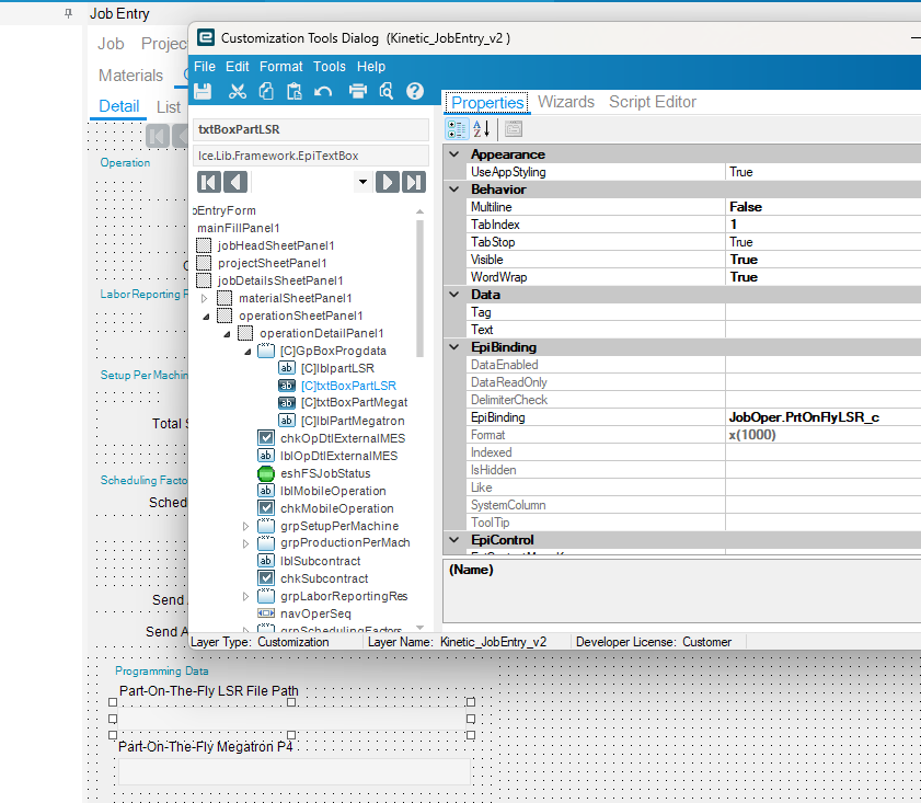

Here is the code behind where i’ve added the fields. I’ve made sure it says visible

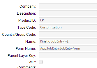

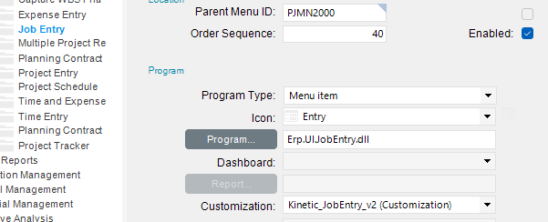

Here is the menu where I am calling the customization.
When I go to through the menu and select the job entry form they do not show on the page. They should show on the form here.
