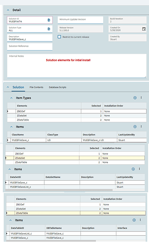

Create a solution in Solution WorkBench – include ZBODef, ZDataSet, ZDataTable items.
Build solution.

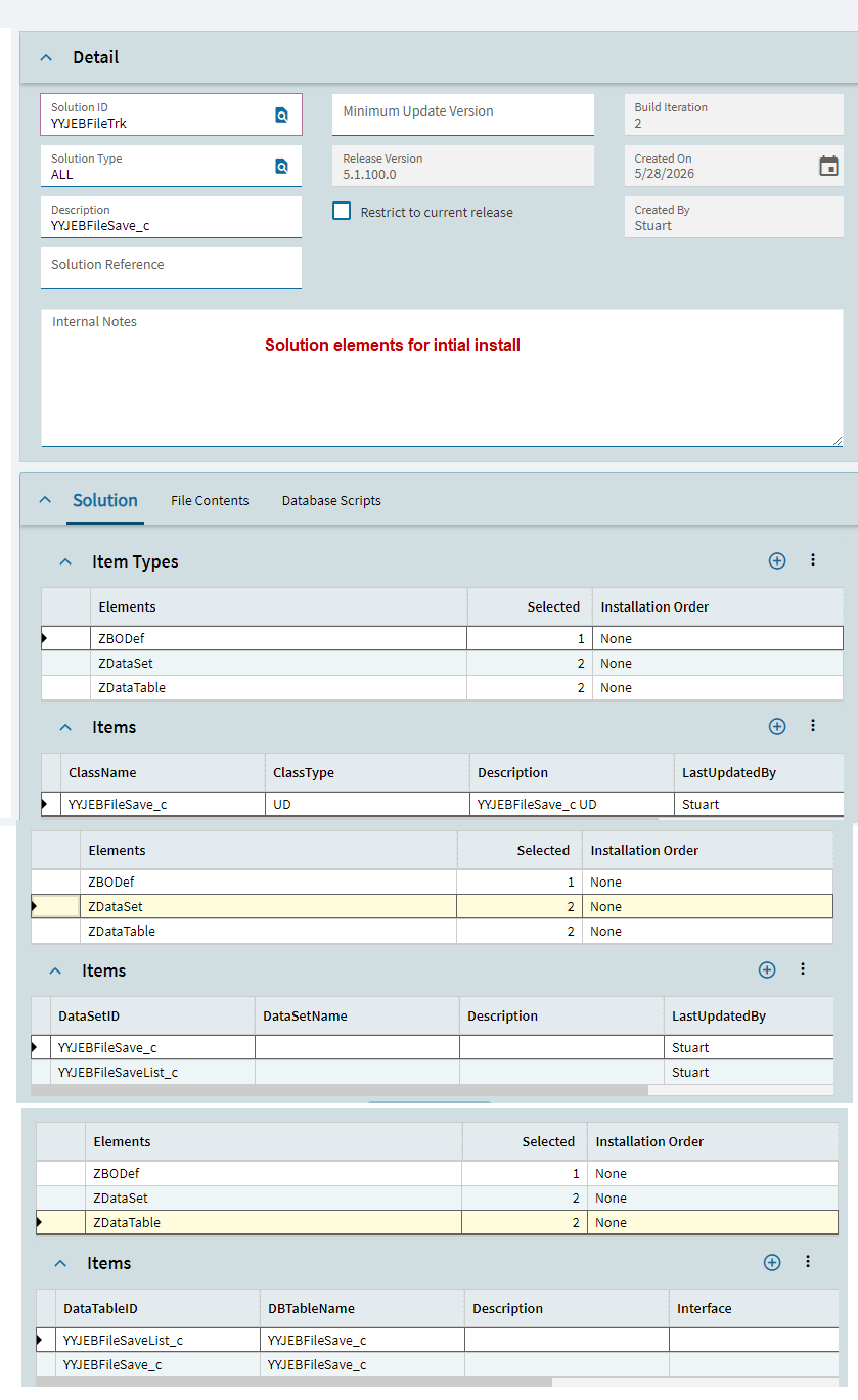

Create new solution in Solution Workbench include ZBODef, ZDataSet, ZDataTable items (same elements as before, new solution).
Build solution.

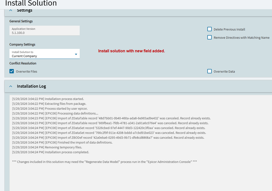

Installed the solution in new environment. Log indicated the ZBO Def record existed, ZDataSet records existed, and ZDataTable records Existed but Finished import of the data definitions.
Regenerate the Data Model per install log suggestion.
Stop/Start Application Pool.

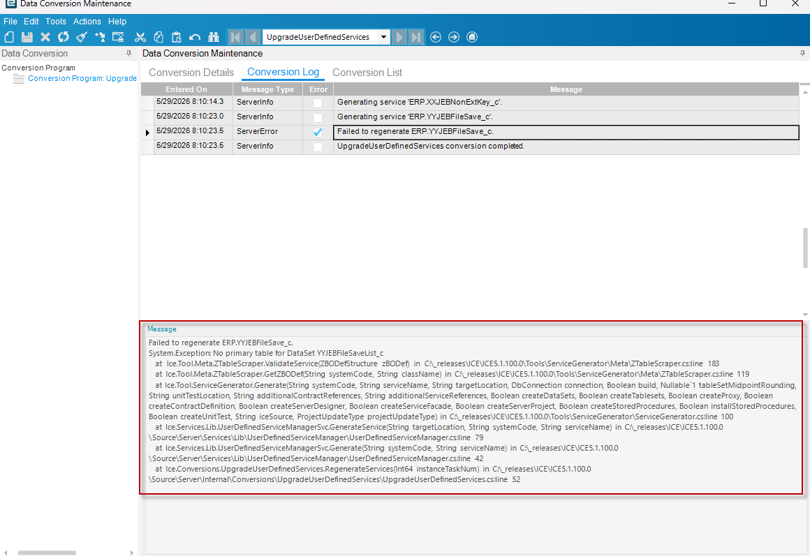

Run Conversion WorkBench Item #210 – UpgradeUserDefined ServicesToBusinessModel (this creates the business objects). This process finished with errors.
Error message:
"Failed to regenerate ERP.YYJEBFileSave_c.
System.Exception: No primary table for DataSet YYJEBFileSaveList_c
at Ice.Tool.Meta.ZTableScraper.ValidateService(ZBODefStructure zBODef) in C:\_releases\ICE\ICE5.1.100.0\Tools\ServiceGenerator\Meta\ZTableScraper.cs:line 183
at Ice.Tool.Meta.ZTableScraper.GetZBODef(String systemCode, String className) in C:\_releases\ICE\ICE5.1.100.0\Tools\ServiceGenerator\Meta\ZTableScraper.cs:line 119
at Ice.Tool.ServiceGenerator.Generate(String systemCode, String serviceName, String targetLocation, DbConnection connection, Boolean build, Nullable`1 tableSetMidpointRounding, String unitTestLocation, String additionalContractReferences, String additionalServiceReferences, Boolean createDataSets, Boolean createTablesets, Boolean createProxy, Boolean createContractDefinition, Boolean createServerDesigner, Boolean createServiceFacade, Boolean createServerProject, Boolean createStoredProcedures, Boolean installStoredProcedures, Boolean createUnitTest, String iceSource, ProjectUpdateType projectUpdateType) in C:\_releases\ICE\ICE5.1.100.0\Tools\ServiceGenerator\ServiceGenerator.cs:line 100
at Ice.Services.Lib.UserDefinedServiceManagerSvc.GenerateService(String targetLocation, String systemCode, String serviceName) in C:\_releases\ICE\ICE5.1.100.0\Source\Server\Services\Lib\UserDefinedServiceManager\UserDefinedServiceManager.cs:line 79
at Ice.Services.Lib.UserDefinedServiceManagerSvc.Generate(String systemCode, String serviceName) in C:\_releases\ICE\ICE5.1.100.0\Source\Server\Services\Lib\UserDefinedServiceManager\UserDefinedServiceManager.cs:line 42
at Ice.Conversions.UpgradeUserDefinedServices.RegenerateServices(Int64 instanceTaskNum) in C:\_releases\ICE\ICE5.1.100.0\Source\Server\Internal\Conversions\UpgradeUserDefinedServices\UpgradeUserDefinedServices.cs:line 52"

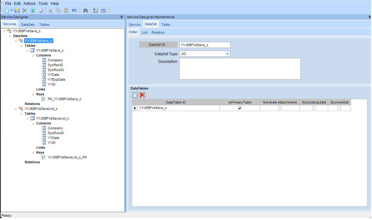

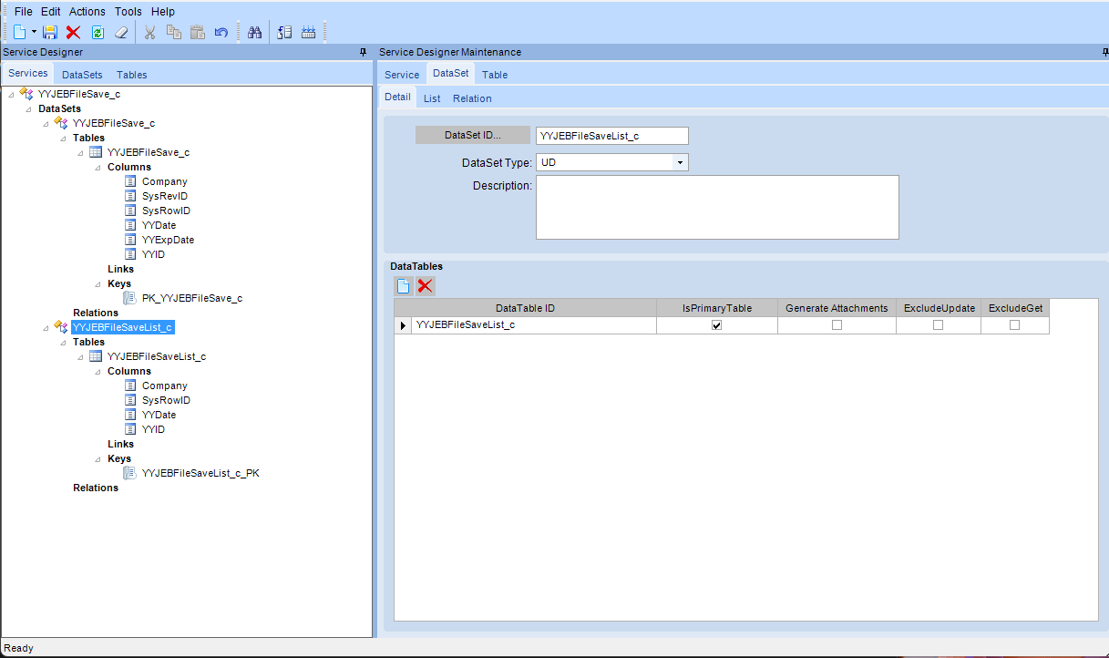

In Service Designer Service looks like this:
Open your dataset and make sure both datasets have a primary table marked.
Is there a place to look other than under DataSets>Details tab in the designer? That is the last illustration above. Checked them again, still marked the same as the screen shots above.

In the solution import I checked the box to “Overwrite Files”. Log file indicated all records that already existed cancelled out the actions. The last action was to “Finish import the import of the data definitions.” (Included in above screen shot).
I regenerated the data model as suggested to see if it went ahead with the overwrite given that statement. I WAS mistaken.
