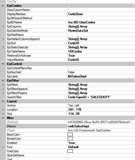

It may require you to change the EpiDataSetMode to List (maybe).
Ok, I’m gonna try! Much appreciate the tip and expalnation!
Actually I misread your post… the above is for UserCodes not UD Table :slight_smile: But you can still use EpiCombo and point it to the Resources table, or UD table too.
