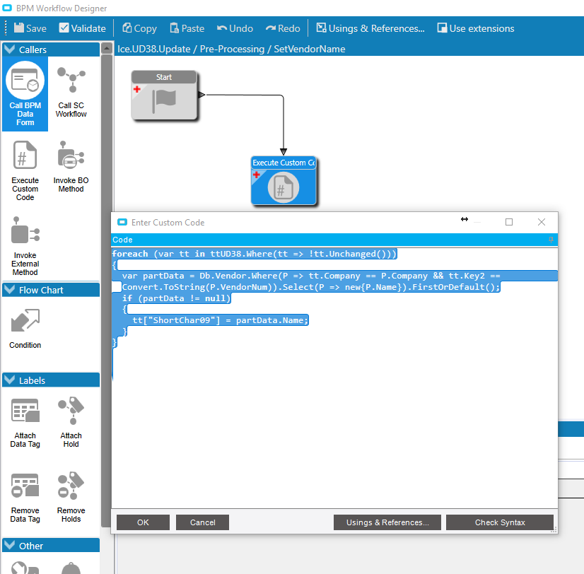

my snytx for BPM comes back with no error but when I run the PM through UBAQ i get a error message for the following “BPM runtime caught an unexpected exception of ‘NotSupportedException’ type.
See more info in the Inner Exception section of Exception Details.”
here is my BPM, I’m sure I’m missing something easy , I just very limited C# experience to address this issue .
foreach (var tt in ttUD38.Where(tt => !tt.Unchanged()))
var partData = Db.Vendor.Where(P => tt.Company == P.Company && tt.Key2 == Convert.ToString(P.VendorNum)).Select(P => new{P.Name}).FirstOrDefault();
if (partData != null)
tt[“ShortChar09”] = partData.Name;

@Adrian There are a couple of ways to get past this error. Convert before the Linq statement or using Sqlfunctions in the linq statement. But I think there may be a cleaner way to do what you are trying. As @NateS asked where does the data sit? How does the baq fit into the data direct email alert? If that is the objective then what does the baq do?

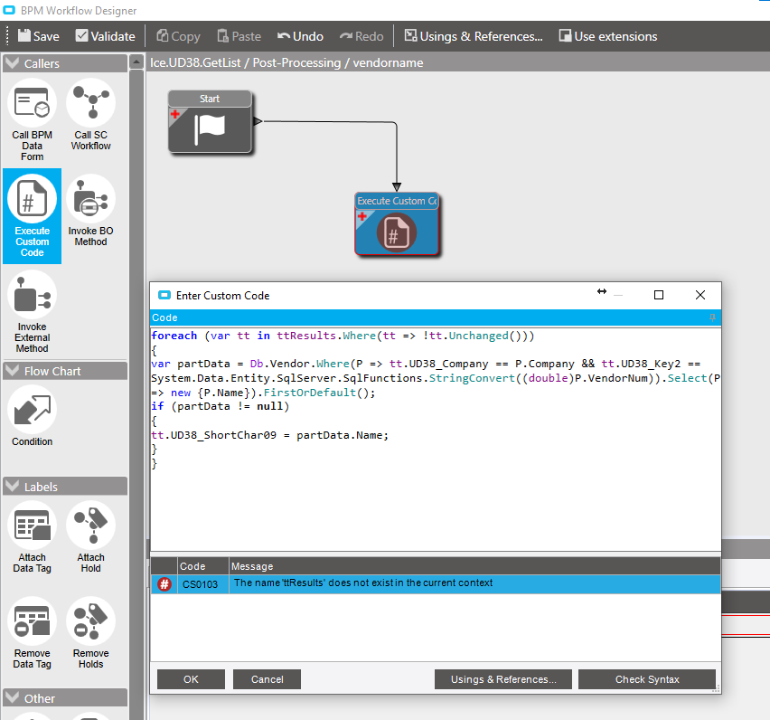

Thanks for the tip and help, I tried your solution and I’m getting an error of " the name ttResults" does not exist in the current context". I’m sure I’m missing something that I’m just not seeing.
foreach (var tt in ttResults.Where(tt => !tt.Unchanged()))
var partData = Db.Vendor.Where(P => tt.UD38_Company == P.Company && tt.UD38_Key2 == System.Data.Entity.SqlServer.SqlFunctions.StringConvert((double)P.VendorNum)).Select(P => new {P.Name}).FirstOrDefault();
tt.UD38_ShortChar09 = partData.Name;
@Adrian The code goes in post processing getlist of the UBAQ not on a UD38 bpm. As @NateS asked what is the goal here? If it is to send an email with data collected from the PO and UD38 I don’t see the purpose of the UBAQ. all of that can be done in the data directive.

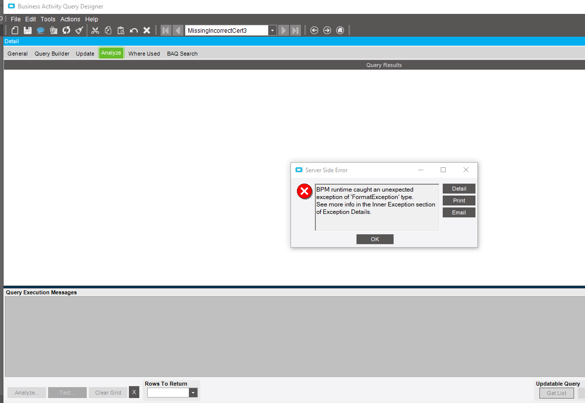

@gpayne I uploaded the sample baq that you provided and when I hit the get list button I encounter an error message. at the bottom of the it states there is a input sting not in correct format.
Inner Exception
Input string was not in a correct format.
BPM runtime caught an unexpected exception of ‘FormatException’ type.

@Adrian I don’t have your data, so I can only make examples. Look at the code below in postprocessing of getlist. I sent it disabled, so it would not be the cause of the error unless you enabled it without changing to fit your data. You see Key2 is the lookup for part and vendor name which is not going to work in a real situation.
