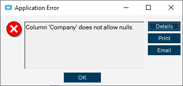

The problem I’m having if there is two lines on the “Lines Detail” section it will add two new lines on the “Unavailable Parts” section I’m trying to make the section it’s own entity seperate from the lines details but have the same properties e.g when tabbed a new line is added or if the API posts a line another line is created waiting information.
Try adding, you will need to register the BeforeRowInsert
private void grdCutPlan_BeforeRowInsert(object sender, Infragistics.Win.UltraWinGrid.BeforeRowInsertEventArgs args)
// Event handling code generated by wizard.
args.Cancel = true; // We are stopping the default Inf Behaviour
oTrans.GetNewOrderDtl(); // We are telling oTrans Get me a new OrderDtl Line
I’m no longer getting that error but when I delete a line from Line Details one gets deleted from Unavailable Parts grid and I am unable to tab to create new line
My end goal is to have the Parts Unavailable to be their own entity because at the moment the lines copy “Line Details” e.g if I create a new line it will add a blank line on “Unavailable Parts” section which I don’t want and I also get an error Part Description is required which I don’t want.
your customization works fine in my version.
out of curiosity, on the 7th post, i noticed you hided lot of key fields.
can you unhide company field and test ?
if users manage the “unavailable part”,
you need to bind ud table to the grid as epidataview, and programmtically load/update/create data between ud table and order entry screen on order line actions.
if users not going to edit/add the “Unavailable part” view, you could simply call run a baq and bind the dataset to the grid.
if your intention of this modification is to manage unavailable stock, i hope you considered epicor “cross-dock” functionality
Yes the data will be posted using REST API from a website so I am wondering how I would create multiple lines in a BAQ based on that Sales Order Number?
