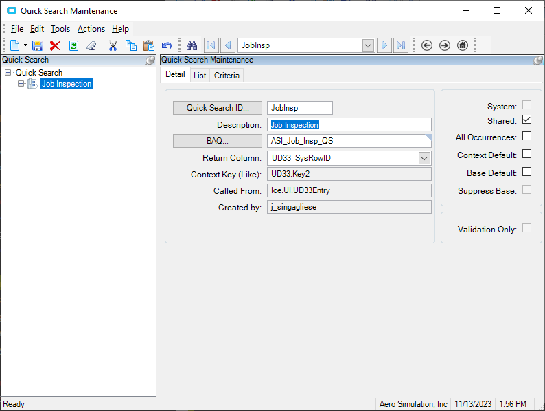

Is this how I would set up SysRowID for the return column?
This still doesn’t return data, so something must be wrong.
