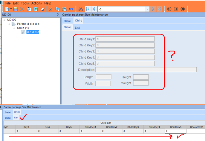

I have never worked with UD Parent/Child before so I am hoping you have seen or heard about something like this and have a fix for it.
The issue is I can not add any children to the detail screen. It lets me add in the list tab but not the detail screen? Have you ever seen this behavior?
