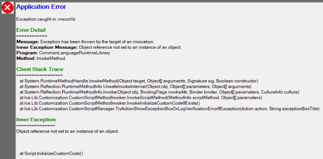

I am adding two data views to an UD05 entry item. The test code function says that there is nothing wrong. However, when I close and reopen the UD05 entry screen with the customization active I get the following error:
I believe this error is caused by the line “InitializeUD05Adapter();” within the Initialize Custom Code block. The reason for this is that when I comment out that section of code everything seems to work as normal. I have included both the Initialize Custom Code block and the InitializeUD05Adapter block below.

Conclusion
The original error was caused by a naming convention error. The error with the customization not saving was that I was using oTran.Update; instead of my declared _ud05Adapter.Update;. As soon as the swap was made it worked like a charm. The moral of the story, don’t fat finger when coding, it’ll save you a lot of headaches.
