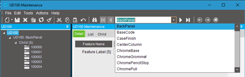

When I pull multiple parent records into UD100 the tree view only displays the first record selected in the search. In order to view the other records I have to use the navControl on the toolbar and either select from the dropdown or use the arrow buttons.
Is there some way to make the tree view list all of the records I select similar to how Resource Group Maintenance works?

Bind to the epidataview called List - look in the object explorer.
I tried that initially, but the List dataview does not include the UD fields for some reason.
Very true - and sad unfortunately. You could maintain your own table (link the UD’s) whenever the List edv changes.
