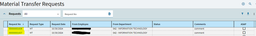

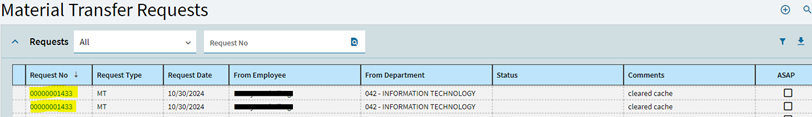

We have a customization using UD100/UD100A tables that has been working fine for 1 year. We upgraded to 2024.1.10 at the end of August and since we are seeing duplicate records on UD100. This is sporadic – not happening to all users and then only happens sometimes to the same user. It is only duplicating the UD100 data and not the UD100A. It seems to duplicate at Save.
Sometimes it repeats the same sequential number (Request No/UD100.Key1) and all other data.
Sometimes it assigns a different sequential number (Request No/UD100.Key1) but all other data is repeated.

This does happen to more than one users but the same users don’t see it every time…it is very strange. We have tried clearing cache which seemed to help for a brief time but then returned…maybe it really didn’t help since this is sporadic.
@josecgomez we did more testing today and the one individual got the first entry to duplicate and could not get any others after. I turned on the “Debug Tool” on the Kinetic menu and was able to get 3 different sets of duplicates but then other entries were just single and the duplicates were not in a row - the were spread throughout my testing. One thing I noticed in the Debug Tool was when a duplicate is created the following were shown twice…not really sure if this indicates anything or not :confused:
