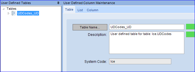

Wondering if anyone has ever created a UD table off of UDCodes. Just wondering how it worked and if there were any issues that it caused.
I did. Use it all the time, no issues.

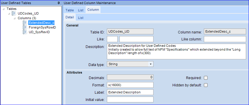

I have:
The only added column I made was an “extended description” because I used it to store an entire specification document text :rofl:
But it works just fine.

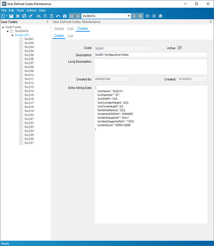

It’s pretty handy to store larger data sets in a familiar way.
I don’t know anymore, man.
Part of me is thinking “Dork - you think this is ‘familiar’?!”
But the instant reaction I had was, “Oh, a JSON string. That makes sense.”
I used to not know this a few years ago…
Also, cool idea.
Well I meant familiar as in “just stick it in a UD Code” lol
I store all kinds of one offs there, and a few configs

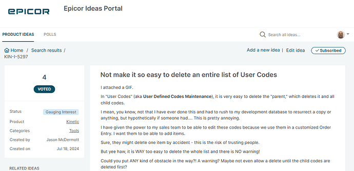

So, have you ever noticed how easy it is to delete the entire library of UD codes? I’m terrified to store any useful things there.
I have a beef with it.
Ha, I forgot I made a GIF of it.
AllGone
Ok, mark that down as something to export on the regular.

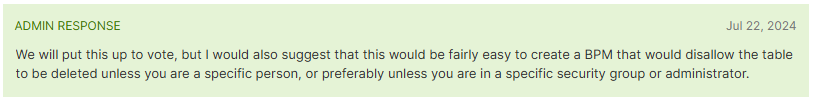

I loved your comment to the Admin response on your idea @JasonMcD
Yeah that admin response was lame.
We make mistakes too. It’s a much bigger issue.
